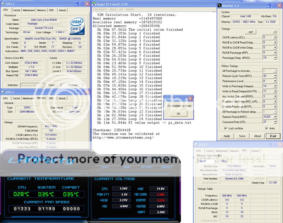

Second kit of TeamXtreem 8500's.
SPI32M @ 542 FSB / 650 MHz @ 2.33v / PL8 / 1.58 vNB
http://i720.photobucket.com/albums/w...33vPL8Kit2.jpg
2.33v for 650MHz C5 32M stable is insane. What chips are under the hood, GKX or GMH? Do you have the newer Team kits with black PCBs, those seem to really fly.
