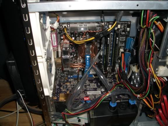

I don't think I am willing to remove my IHS just yet. I did, however, get an Asetek WaterChill cooling system installed...Quote:
Originally Posted by ChkDsk
http://i99.photobucket.com/albums/l2...l/df87813c.jpg
I have gotten my oc stable at 2.607 GHz (237 x 11) with my memory on a 166 divider, 1T, timings on auto, but I need 1.52 volts to make it work. While torture testing both cores, temps max out at 44 degrees, a full 9 degrees cooler than my Zalman with an oc of 2.45 GHz at 1.42 v.
My next order of business is going to be to remove the memory divider (other members with similar setups to mine say that my memory can easily do 260 mhz with slightly loosened timings), and tweak with the timings.
My main question at this point is this...as long as my CPU temp stays under 50 degrees, can I increase the vcore some more? What is the practical ceiling for this chip?
Thanks for all your help!
Mark
