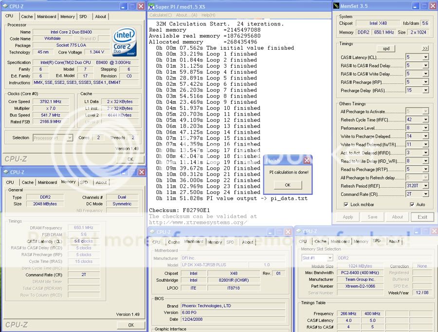

Some preliminary results with my X48-T2RSB Plus.
SPI32M @ 542 FSB / 650 MHz / PL8
http://i720.photobucket.com/albums/w...6501MHzPL8.jpg

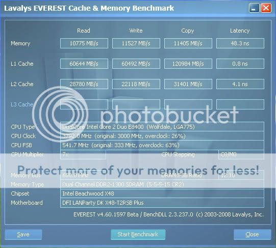

Everest @ 542 FSB / 650 MHz / PL8

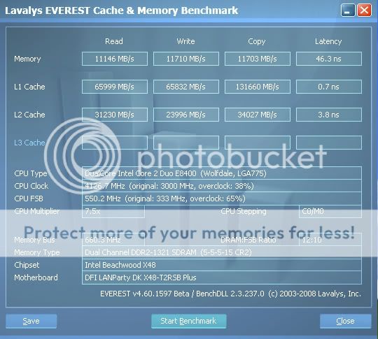

Everest @ 550 FSB / 660 MHz / PL8
http://i720.photobucket.com/albums/w...B660MHzPL8.jpg
