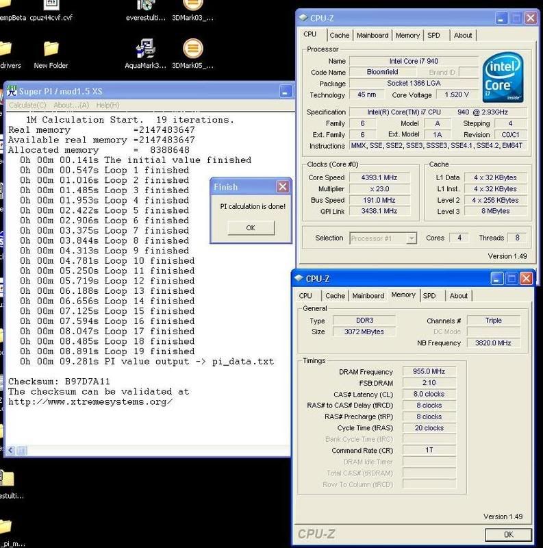

4600mhz done on air..
http://valid.canardpc.com/show_oc.php?id=495579
And you ReverendMaynard dont bather...

Well... currently i have set 1.3v in Bios, cpu-z shows 1.280v idle and 1.264v in full... 0.02v diff in idle and 0.036v in full... tell me if this is not some considerable number...
Nothing fancy here. Tried to run my memory in 1800mhz with standard timings, and itīs seem to work well, atleast for Superpi :)
Vcore: 1.3250 in bios " Showing 1.28 in Cpuz "
uncore: 20
Qpi/Vtt: 1,51
PLL : 1.86
Dram: 1.66

Just posting some results...
I have a ATI X2 in the same Wc loop, that is why the high temps.
Bios F5e. 1.216 vcore 3800 mhz :D
