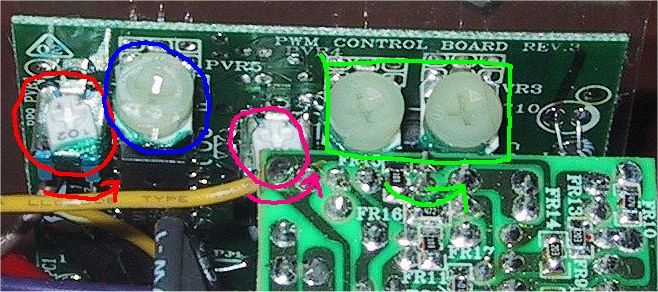

http://www.adventurevision.com/somep...rtron-pots.jpg
Red = 3.3v adjustment
Blue = +12v overcurrent adjustment
Fushia = +5v/+12v adjustment
Green = ???overcurrent adjustment or fan speed???
Just verified that the BLUE pot. is for +12v overcurrent protection. (it also may control the +5v overcurrent protection but I have not been able to prove that)
Is anybody sure what the GREEN pots. do? I always assumed they were related to more overcurrent protection circuits but others have said they control the power supplies fan speed. I took the DMM to the fans and I can't get those pots to change the fan voltage so... :confused:
i think the greens control the speed of the fan when the temperature gets too hot and spins up the fans. i believe when it kicks on these set how fast it will spin up to control the noise.
