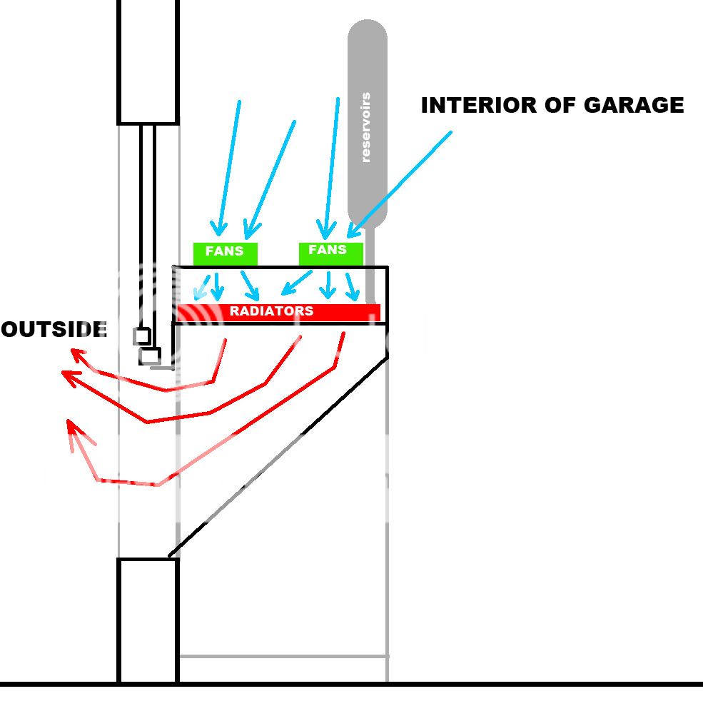

I agree with fallwind, the fans don't need to be right on the radiator, in fact it is probably better if it isn't. If the fan is right on the radiator, there is a dead spot in the middle of the fan where the air hardly moves. That is why fan shrouds were great.
I agree also, I built my radiator box with 2 x 8's so the interior depth is nearly 8 inches and my rads are only ~2" in height. The box is a shroud so the fans can slowly force air through the entire surface of the radiators. The fans i'm mounting on the top exterior surface of the Rad's.
I like the suggestion of using disassembled 115 off the shelf fans but for my project to work airflow is just to critical. If the fans are unable to force the air though my shroud, rads, then exhaust out the side window then the heated air will back up into my garage very quickly pushing interior temperatures over 100F. I drew a quickie diagram to illustrate exactly whats going on inside that massive black box that sits in front of the window:
http://i399.photobucket.com/albums/p...ct/airflow.jpg
So with airflow being so critical I went ahead and ordered 6 of these http://www.newark.com/sunon/a1259-mb...vac/dp/20M3858. Unfortunately it will probably take two weeks or so before these things show up, i'm not expecting them anytime soon. I feel the high static pressure of these monster fans ought to ensure hot air is exhausted out my window and cooler air is drawn into the garage. My air intake is along the top edge of my 2 car garage door, roughly 1" - 1.5" gap extending the length of the door.

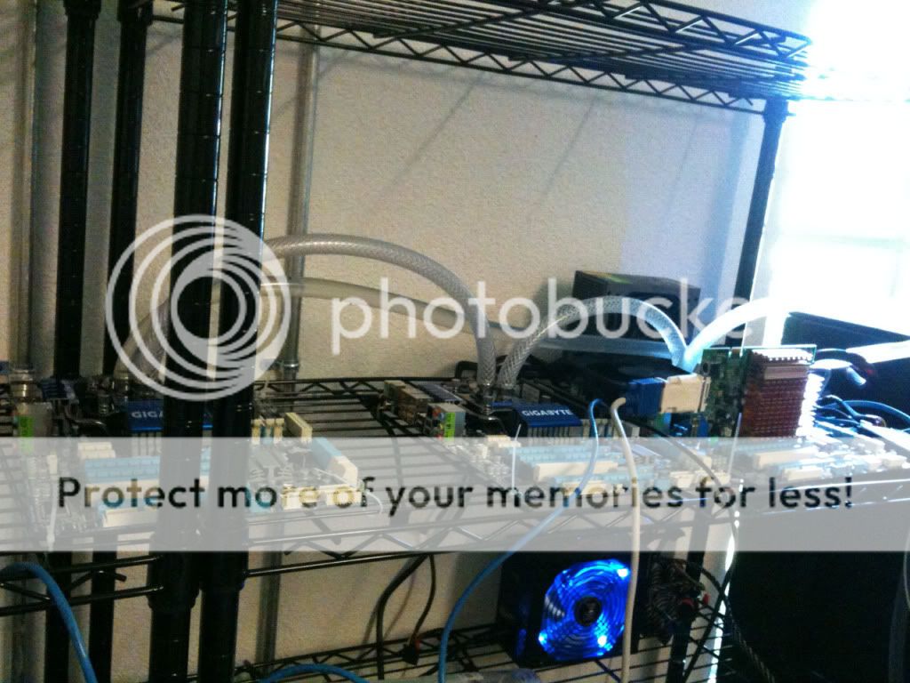

For pump testing I installed 1 sub loop of 3 rigs. The sub loop has a 970 > L5640 > L5640 > Res. Right now I only have the first rig, the 970 up for testing. Disregard the voltages in the CPUz shot of the 970, I did not do any tweaking of the voltages or testing. I entered bios once, turned bclk up to 168 (x25) for 4.2GHz and then just took a guess at a nice safe voltage a gulftown should run 4.2GHz at. I have no idea what the minimal voltage is required to run a 970 at 4.2GHz is right now, thats an issue for later. Loop works OK and flow is so-so. Not bad temps for passive cooling :cool: To help make sure I have no future flow problems I went ahead and ordered one of these http://www.grainger.com/Grainger/TAC...C90?Pid=search along with flanges and O-Rings. I plan to install the pump between the 2 radiators (because there is lots of room for the pump there :rolleyes:)

How are the boards insulated from the racking? I ran some with neoprene under for a while and it all got stuck to the hot parts of the board. (sorry if you posted this already and I missed it)

Good question, my first plan was to buy sheets of window glass to insulate the boards. A sheet of window glass comes precut and is like $2 or something very cheap. But right now i'm not sure if its needed, I bought metal wire shelves and they have a black epoxy coating on them, so while testing I just zip tie'd the boards directly to the shelves. So far zero heat problems or electrical grounding. While I continue to run my 1 test loop i'll keep a eye on this, but if it continues not to be an issue i'll just zip tie em right to the shelving.
I guess I was thinking that running 24/7 could just about produce enough heat on a component to "melt" the coating on the wire and give problems to say the least. I like the idea of glass by the way... how about you get say 3 * 2 inch strips per board...enough to insulate but lets the air get to the back of the board still. Just a thought ;)

Ok, that sold me :D i'll find a way to insulate the boards :D

you should try maybe plywood?Quote:
Ok, that sold me i'll find a way to insulate the boards
these 5mm thick pieces, isolates, flexible, cut-able, non fragile and soft on taking any sharp edges :).

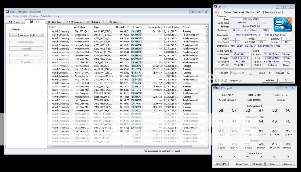

And I finished setting up my test loop, I have a 970 @ 4.2GHz, and 2 L5640's at 3.7GHz on one loop and an air cooled gtx460 to 'stress test' my cooling (no fans still.) So far passively the loop is handling it just fine, temps on the 970 only raised 1 - 2c when the extra computers and 460's were added; looks like a good sign once I get the system rebuilt with an extra pump and have fans :)
