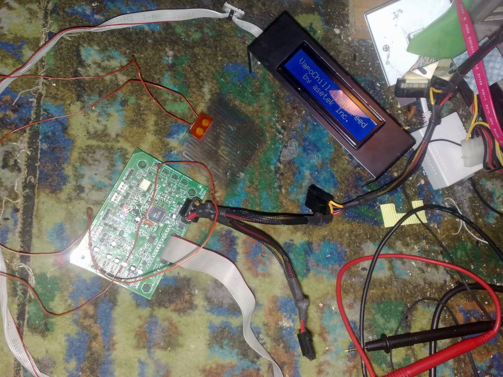

heres what i had in mind
an old vapo chill heater fitted bettwen the pot and the card
http://i556.photobucket.com/albums/s...6072010821.jpg

@ EvoCarlos- vapo chill heater..nice..and yeah, almost the same thing.
do you think it will work ?
http://i556.photobucket.com/albums/s...6072010822.jpg
it gets walm to the touch at 3v and its rated @ 5w 12v
