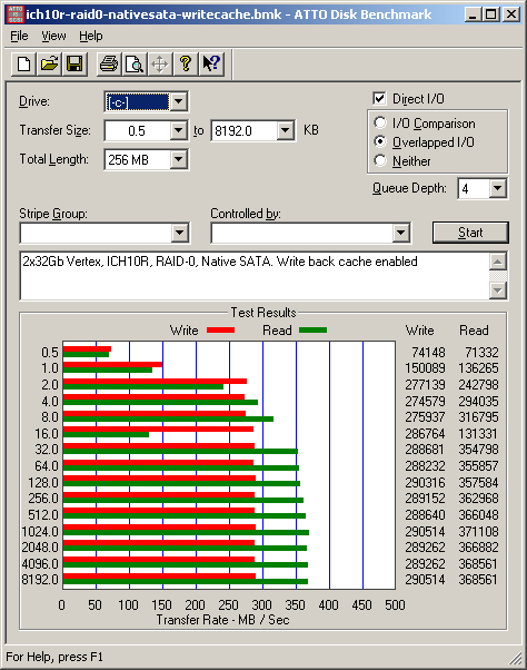

2x32Gb Vertex on ICH10R RAID0, Native SATA mode on, write-back cache ON.
Before (sorry it was not totally reset when I benched that)
http://i214.photobucket.com/albums/c...ta-wbcache.png

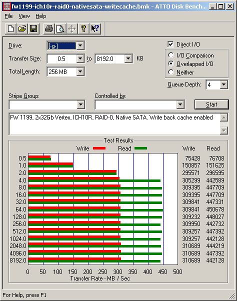

After (clean wiped by flashing)
http://i214.photobucket.com/albums/c...esata-wbca.png
http://i214.photobucket.com/albums/c...0-nativesa.png

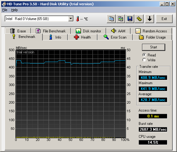

Okay, I'm back....even though I was lazy and didn't come right after the update. I ran some benchies, take a look:
2x30GB Vertex SSDs with the latest firmware update.
128 Stripe RAID0 w/ 128 Offset (alignment)
screen shot is crappy, but I'm tired, its late:
