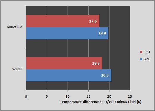

heres your other tests i was staring at....
http://i76.photobucket.com/albums/j11/bf2nut/nano1.jpg
cpu results
18.3 -17.6 = 0.7 .....umm? not even 1 degree diff,im sticking with stainfree fesser water here.
gpu results
20.5 -19.8 = 0.7 again not even 1 degree diff....?
http://i76.photobucket.com/albums/j11/bf2nut/nano2.jpg
ok this test....nobody uses 1 fan rads here.2 min so im looking at the 2 fan rad setup test u did..
9.0 -8.9 = 0.1 !!?!?!? ummm why on earth would i(or anyone)switch to this.its def not for performance.to have white fluid that will stain my tubing in a few months?
