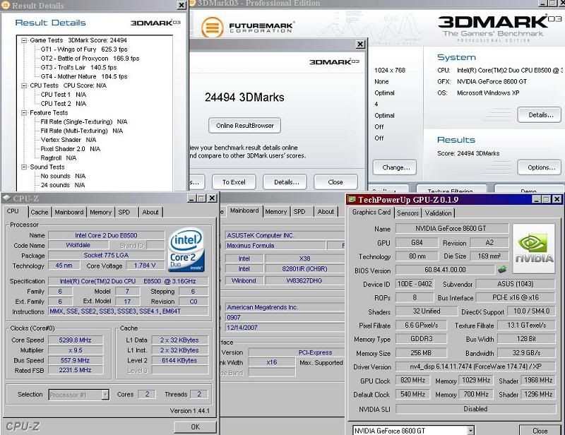

my old test with Asus 8600GT Top OC Gear ediition
card was pencil modded to arround 1.5v and cooled with 10c water
http://i498.photobucket.com/albums/r...OC2/8600GT.jpg

well ive modded mine and im at 1.48v hitting 891mhz core.....
have not worked on the memory, it was supposed to be samsung memory from the reviews i searched. but i got gaymondia... have not started to clock the memory....
also i got the asus 512mb silent and i am liking it..:up:
edit: can you guys please post your memory voltages? mine are having trouble even getting passed 800.. might need to lower voltages instead...
