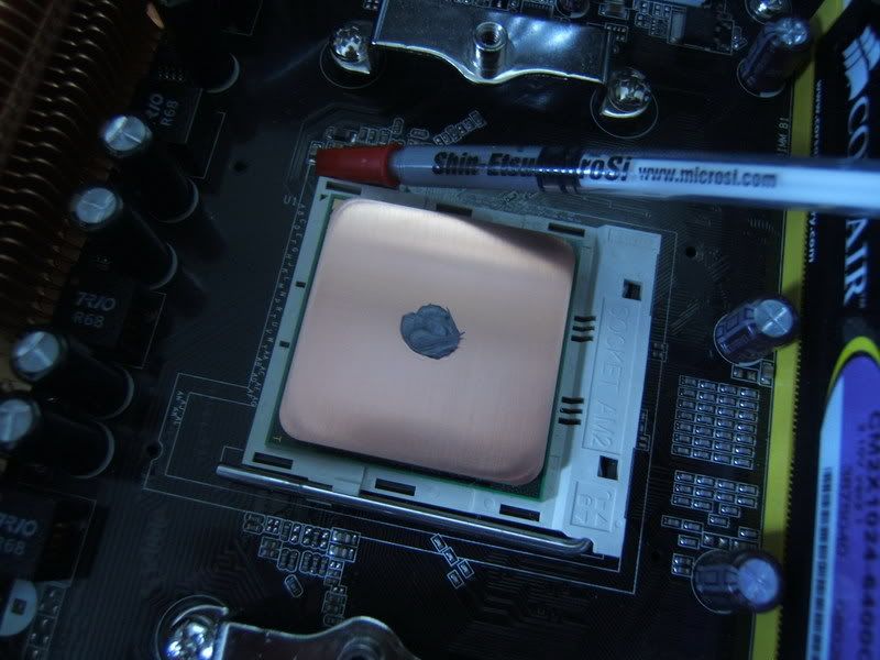

I applied the Shin Etsu x23.
AS5 initial data as posted 4-8-08
pea spreading - cure time of 8hrs no thermal cycling - ambient of 19C
idle temps:
core 1: 23C
core 2: 29C
WCG 100% load temps
core 1: 29-30C
core 2: 36-38C

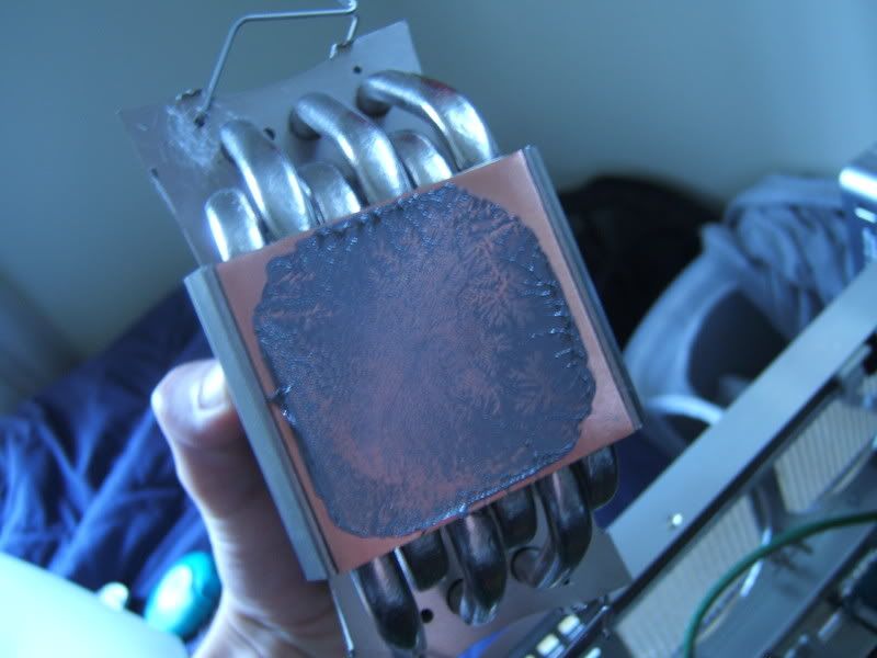

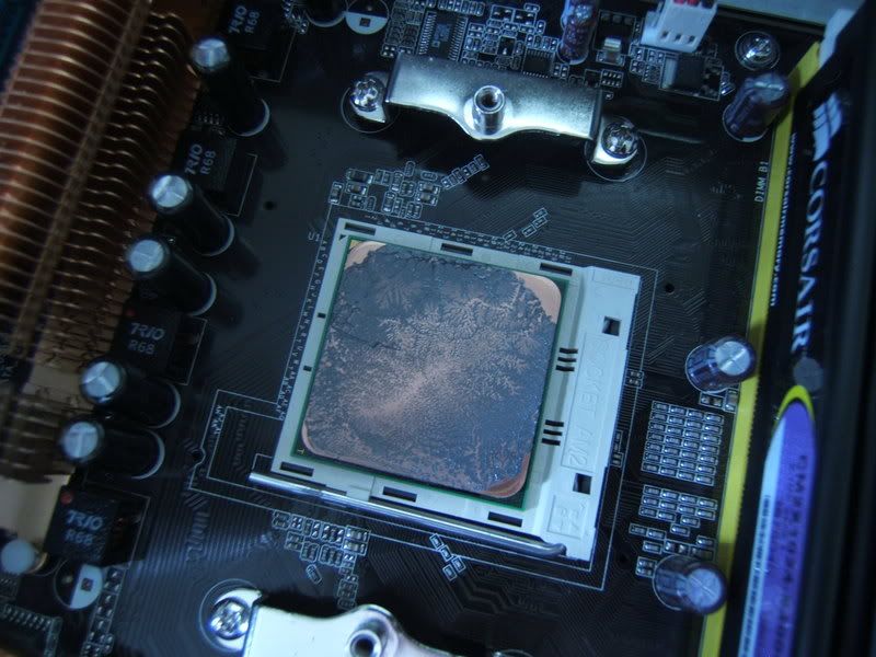

heres how it looked when i took the heatsink off
http://i37.photobucket.com/albums/e9...e/DSCF3045.jpg
http://i37.photobucket.com/albums/e9...e/DSCF3046.jpg
Shin Etsu blob
http://i37.photobucket.com/albums/e9...e/DSCF3049.jpg
Shin Etsu X23 - ambient of 22C
idle temps: taken 10 minutes after startup
core 1: 24C
core 2: 30C
WCG 100% load - after 20 minutes
core 1: 33-35C
core 2: 38-40C
i'll update this later tonight to show after 8 or so hours to be more comparable to the AS5 initial values. the Shin Etsu is definatly thicker stuff and seems like it has no oils in it so i expect it to take longer to spread out under the weight of the heatsink

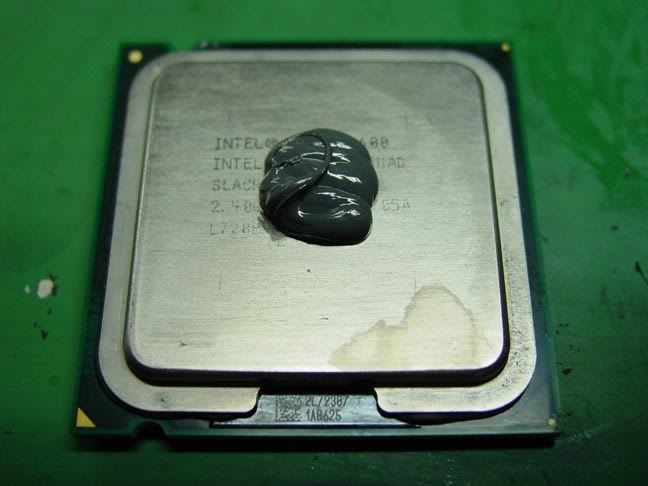

I used a healthy pea blob with D7. Here it is
http://i149.photobucket.com/albums/s...7d7peablob.jpg

D7 - After Temps
Idle:
Ambient 26.1C
CoreTemp 45,45,40,43
Load:
Ambient 24.6C
BOINC, 16 hours running
Coretemp 61,60,58,60
As you can see, the D7 beat the old Shin Etsu mount quite well. Several degrees when you factor ambients in.....
It really is looking like this D7 stuff is "the :banana::banana::banana::banana:". Schweet!
