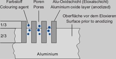

The bottom is aluminum that has been hard anodized by Rhodes A.G.
I pilfered a bit off the site that concerns us:
Corrosion-Protection
Anodized layers, produced according to accerted standards, possess an excellent durability against industrial and sea athmospheres.
Layer Build-Up
During the hard-anodizing process the oxide layer grows (different from decorative anodizing) forming columns to about 50% within the base material, the other 50% builds up externally.
http://i12.photobucket.com/albums/a2...ichtaufbau.jpg
Characteristics of Hard-Coating
• Hardness: 300 to 450 HV
• Layer thickness: up to 140 µm
• Material self-colouring capacity
• Wear-resistant – similar to hard-chrome
• Corrosion resistant against climatic influences
and a multitude of chemicals
