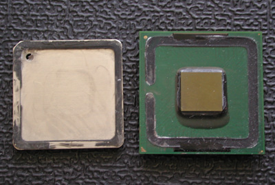

Just imagine the heat coming off theose edges in the picture below. And try to imagine which circuits may reside against those edges in the photo. It's a significant amount of space. When you "swivel" the processor, your forcing paste over those edges, like throwing a blanket over the sides. ;)
Wow.....look at that lap job! :D
Thank's :) here's a better, Reflection-shot. I was thinking of doing it as a goof, like a photo shoot. "P4 in the nude" ya know, place it on a silk pillowcase, with a rose....

Liquid3D - Have a look at this photo of a P4 without the heatspreader. There are no circuits residing against the edges of the heatspreader. Truth be known, the heatspreader is more of a core protector. The vast majority of the heat goes straight up from the core to the heatsink.
OMG I forgot about that, in fact I've seen those pics the first time I read a "removal of the P4 heatspreasder article". I am the biggest Ass on the Internet.
