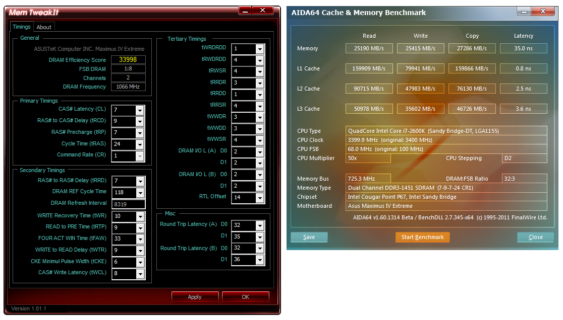

Boot:
http://img.photobucket.com/albums/v2...0M4E/stock.png
Subs with TweakIt:
http://img.photobucket.com/albums/v2...E/subs_1-1.png
Cannot change tWR, it goes back to value from bios after i hit apply.

Thank's to Asus for this fantastic Motherboard::clap:
Next i wil try the new Bios with the Memory tweaker tool !
http://img717.imageshack.us/img717/2172/aida28000.jpg
woow.. great mem clock :D
which bios would u test now ??
