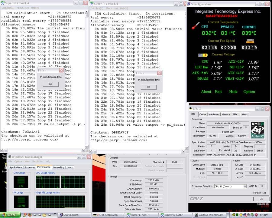

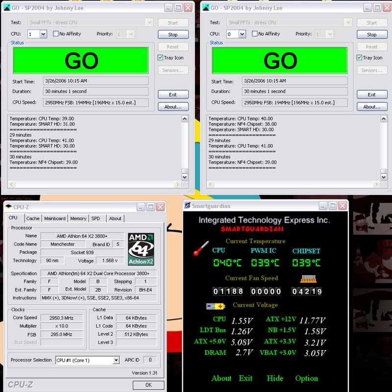

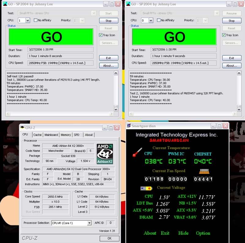

Overclocking report
3800+ X2 LDBHE 0601TPMW 0203 batch, "N"
http://img.photobucket.com/albums/v7...g/3cab923f.jpg
Cooling is custom watercooling in sig, mobo/ram all in sig
Validation screenshot @ 3.26 Ghz, first attempt, 1.60 volts
http://valid.x86-secret.com/show_oc?id=82763
Some priming
2.85 Ghz 1.5v
http://img.photobucket.com/albums/v7...g/20c619f0.jpg
2.95 Ghz 1.56v (cold room, usually needs 1.6v and loads at 45c)
http://img.photobucket.com/albums/v7...g/5c9b1873.jpg
will not prime at 3 Ghz with any voltage to save its life, even with a pretty chilly room
Super Pi goes somewhere though
http://img.photobucket.com/albums/v7...g/650a44d4.jpg
