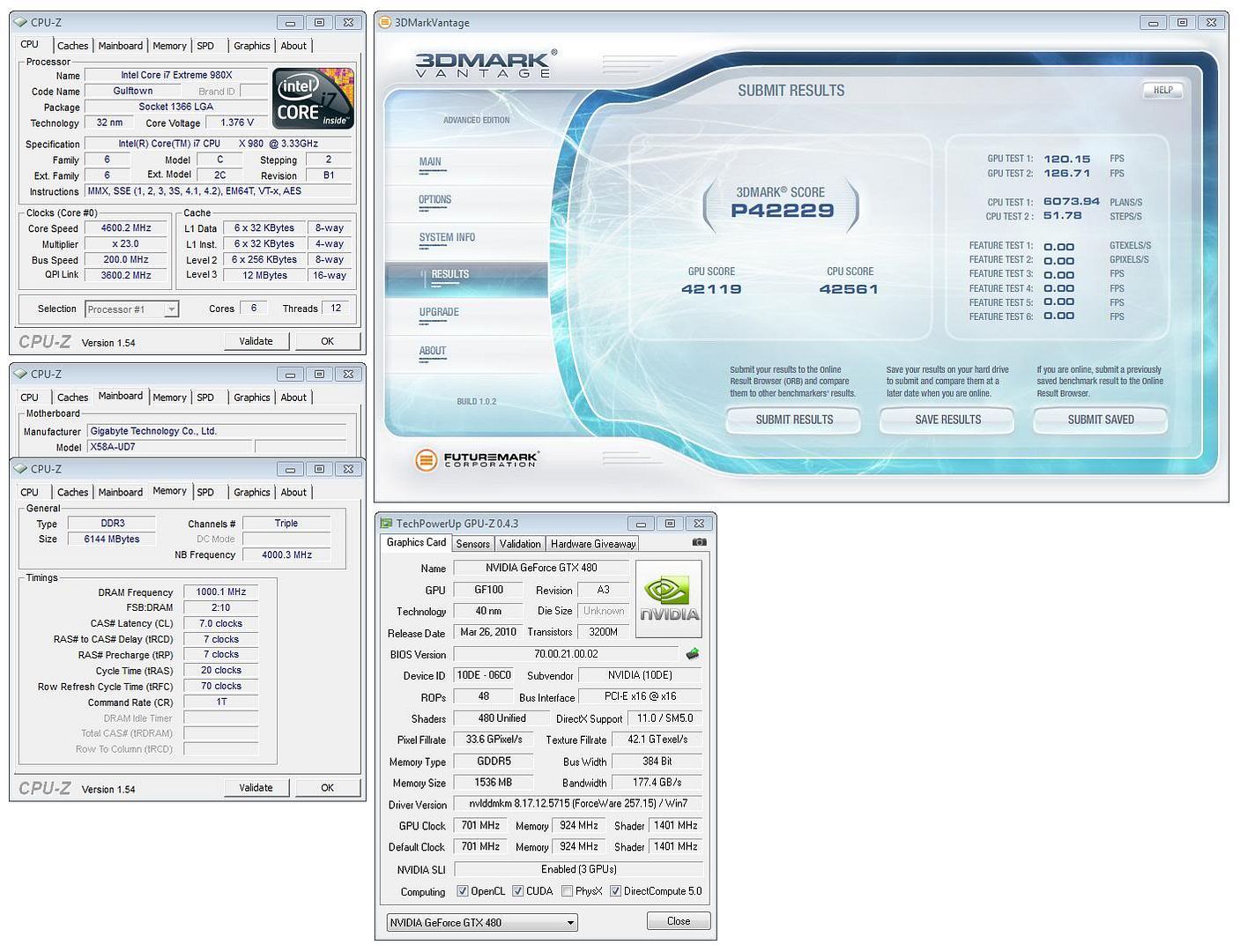

My score:
http://img822.imageshack.us/img822/1...440013375v.jpg
Enjoy it ;)
PS: Powered by Noctua NH-D14 (AIR COOLING) ;)

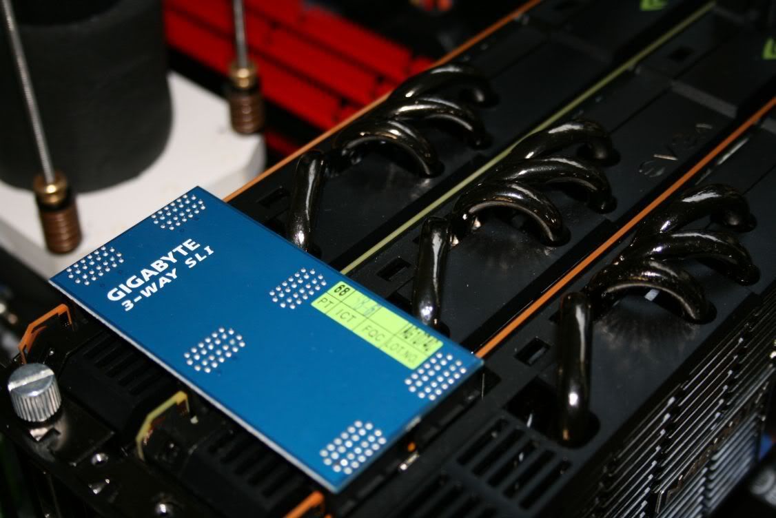

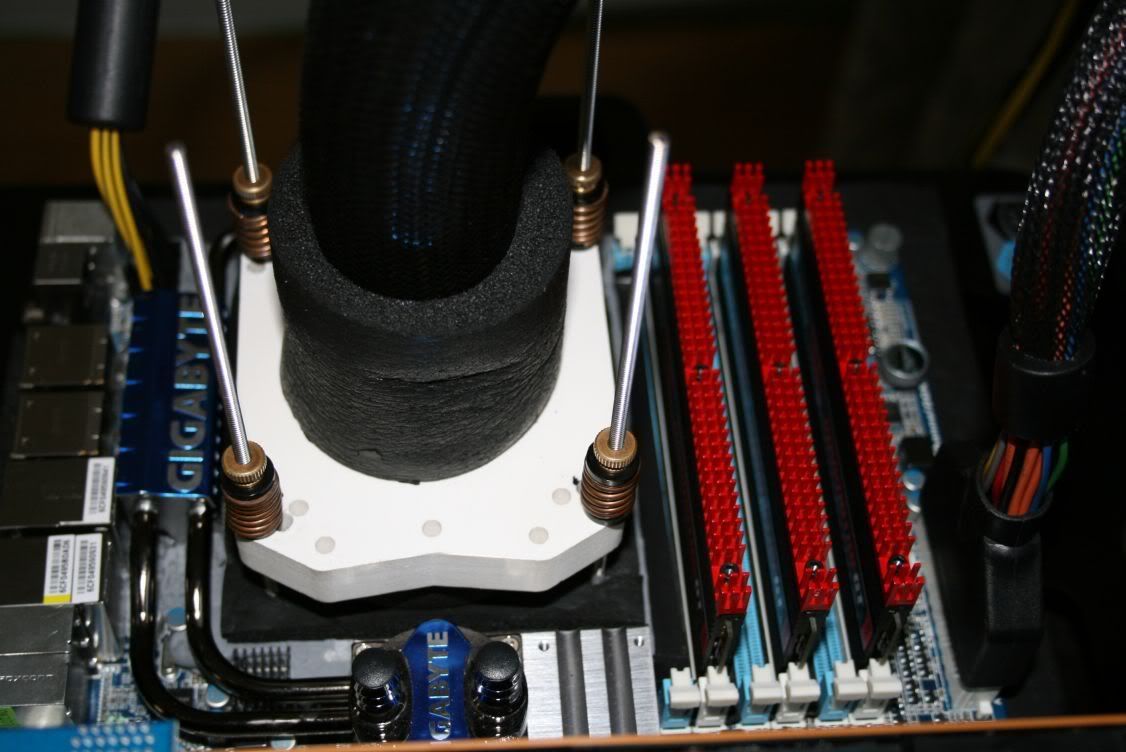

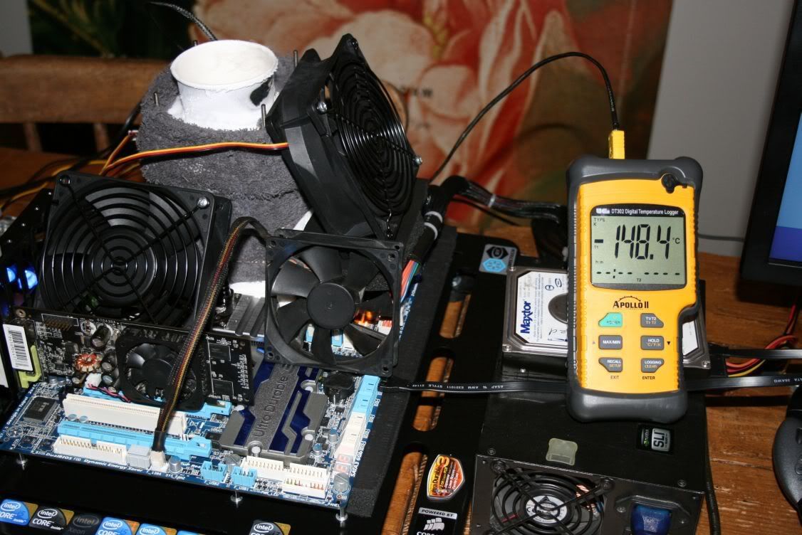

X58A-UD7 roxx :D
3xSLI with CPU @ SS:
http://img.photobucket.com/albums/v2...tec_1200_5.jpg
http://img.photobucket.com/albums/v2...tec_1200_4.jpg
http://img.photobucket.com/albums/v2...tec_1200_3.jpg
http://img.photobucket.com/albums/v2...73xSLI2003.jpg
http://img.photobucket.com/albums/v2...UD73xSLIVP.jpg

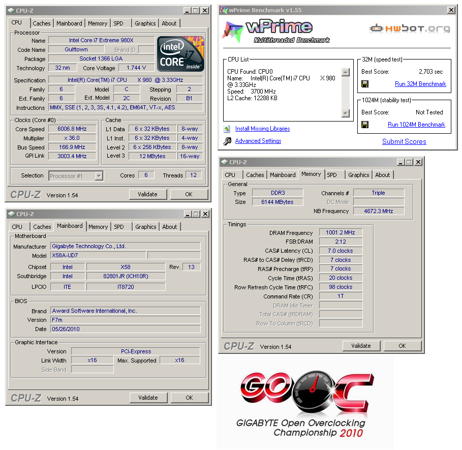

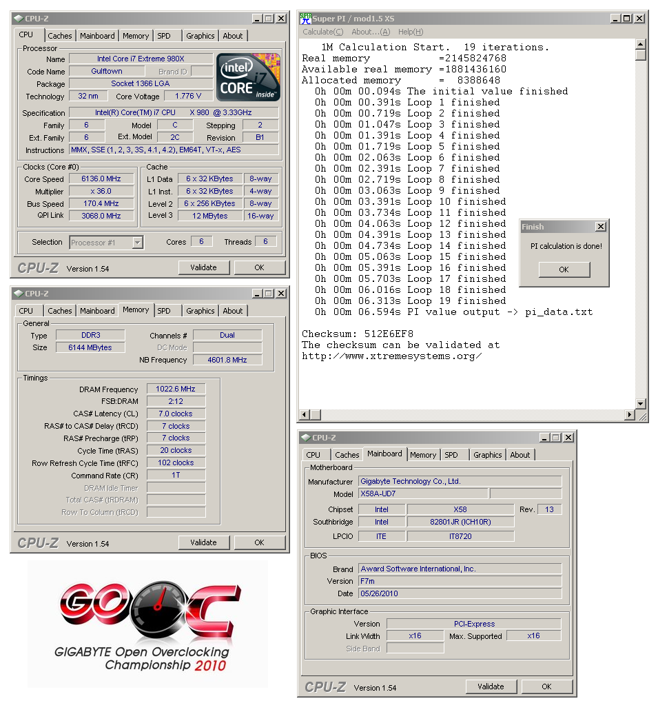

2D for GOOC 2010 EU qualifications:
http://img.photobucket.com/albums/v2...2010_setup.jpg
http://img.photobucket.com/albums/v2...wPrime_32M.png
http://img.photobucket.com/albums/v2...SuperPI_1M.png
