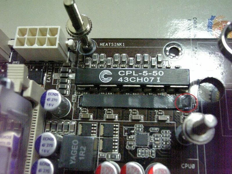

I am investigating a theory on why the VRM may be failing. It's just a theory, but based on the info in this thread and elsewhere, the logic is at least plausible.
IIRC, there was a photo a few pages back that someone had taken of the actual VRM that had burned up. I can't find it now, naturally, but it was the VRM under Heatsink 1, nearest CPU0.
Here is a photo of the row of VRMs that live under Heatsink 1:
http://www.myme.mine.nu/blog/digilog...20x240-323.jpg
This photo is from a blog of an attempt to convert Heatsink 1 to home-built water cooling.
If I am remembering correctly, the rightmost VRM in the photo (under the thermal pad) is the one that burned up.

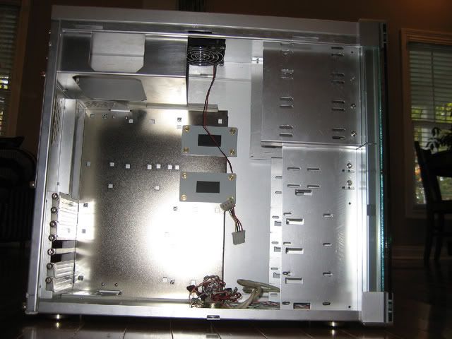

The Z7S is an SSI CEB form factor motherboard. While it is based on the ATX specification, it is not an ATX board. Specifically, the maximum size for a full ATX board (not extended or EATX) is 12" x 9.6" while SSI CEB is 12" x 10.5", and the SSI CEB specification calls for mounting points for the CPU coolers.
However, since it is based on the ATX specification, the SSI CEB Z7S can fit in many standard ATX cases with some slight modification to provide the needed mounting points for the CPU coolers. Thus, the Z7S comes with a backplate kit for mounting the CPU coolers in a case that was not designed for an SSI CEB motherboard. The Z7S does not, however, come with instructions on how to actually mount the kit. This is a picture of the kit that came with the motherboard:
http://img.photobucket.com/albums/v6...tingplates.jpg
It consists of a thin plastic template, two steel adhesive-backed plates, and three baggies consisting of two rubber spacers and eight standoffs a piece, with each baggy containing spacers and standoffs of a different height.
And here are the directions that probably should have come with the kit:
1) Place the template on your motherboard tray, lining up the holes in the template with the standoffs in the top right corner of the tray.
2) Remove the backing from the adhesive on one of the steel plates, and, using the template as a guide, stick it to the motherboard tray. Repeat for the second plate.
3) Find the baggy containing the standoffs that, when screwed on to the plate, match the height of the standard ATX standoffs already in your case.
4) Once you have determined which baggy to use, secure the eight standoffs to the plates, using an adjustable crescent wrench to ensure a tight fit.
5) Now remove the backing from the adhesive on the rubber spacers from the same baggy and stick them onto the metal plates, placing them within the guide lines etched into each plate. The rubber spacers prevent the motherboard from being flexed towards the motherboard tray when mounting the CPU coolers. They perform the same important function as the CEK spring clips used when mounting the board to an SSI CEB case.
Here is what it should look like. This is a picture of my old Cooler Master ATC-210, in which my Z7S was mounted for over a year:
http://img.photobucket.com/albums/v6...l/IMG_2955.jpg
http://img.photobucket.com/albums/v6...l/IMG_2958.jpg
I had to buy another of these kits from ASUS in order to mount the Z7S in its current case, a Cooler Master Cosmos. No amount of reasonable force could have removed the plates from the old case without damaging something. The adhesive is quite strong.
The theory is that perhaps the mounting of the cooler for CPU0 is flexing the board enough to pull the rightmost VRM from its heatsink, causing it to wear out faster than it should. An SSI CEB motherboard could be especially vulnerable to flexing caused by the CPU coolers, since the coolers are mounted directly to the tray beneath the motherboard, rather than the motherboard itself. Forgoing the use of the rubber spacers could exacerbate the problem.

the board just died with burned VRM some days ago when i switched the octo:banana::banana::banana::banana::banana: back on after 2 weeks holiday.

after professional investigation i found similar problems with the vrm's and the smell did come exactly from the heatsink above them.

Roman, did you happen to notice which VRM failed? Was it the rightmost VRM under heatsink 1?
http://img.photobucket.com/albums/v632/Syndil/VRM_1.jpg

sorry for the poor quality. the quickshot from the mobile should do the trick anyway. as you can see it's the second from the left.
http://picfront.de/d/FP4GwMLGw/IMG00...91119-1211.jpg

Thanks for the pic, RomanZen. Doesn't appear to be any rhyme or reason to it then. Just bad VRMs.
