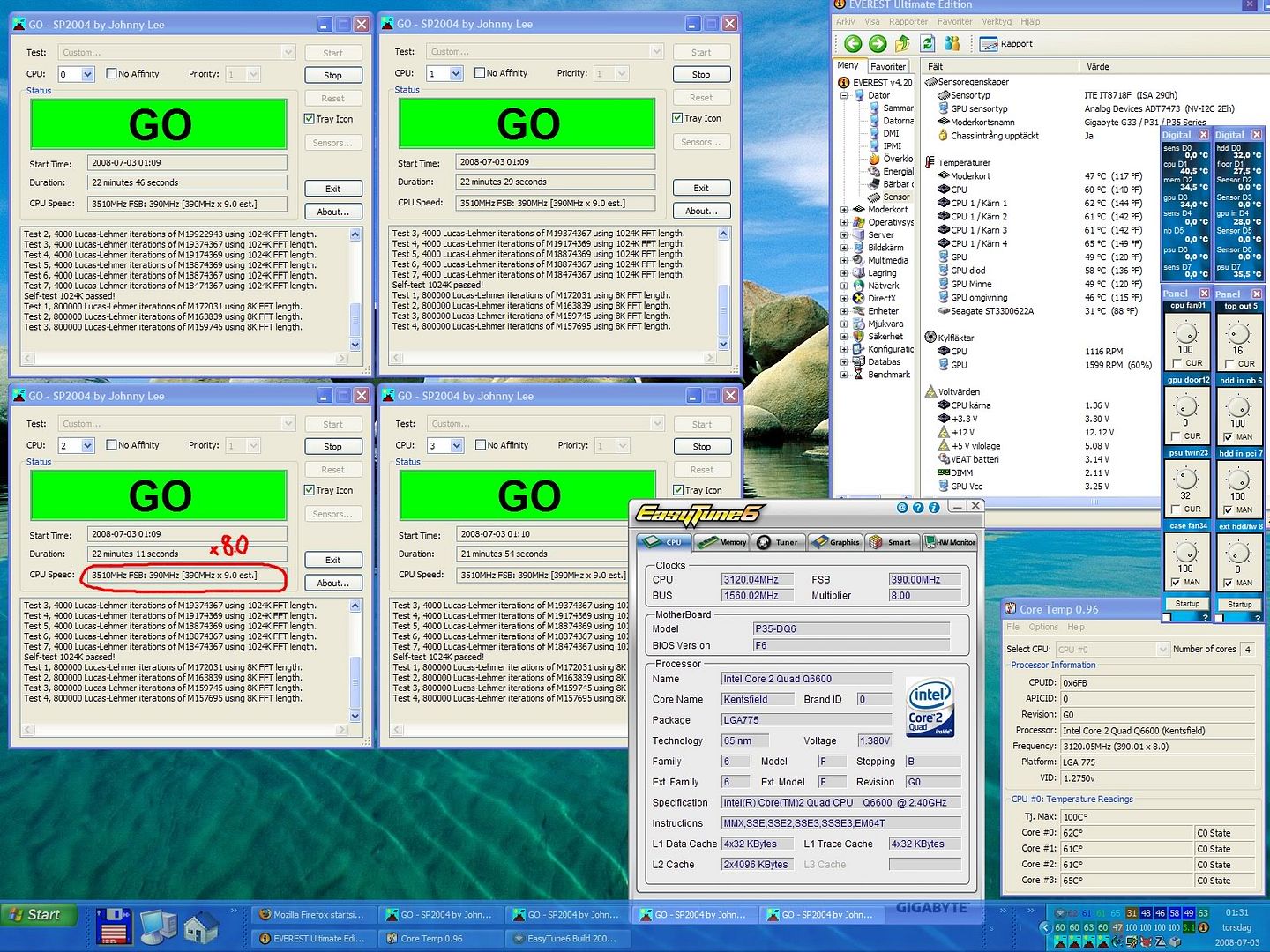

As seen here i'm using Everest, CoreTemp, EasyTune 6, T-Balancer,
for a reference to RealTemp and the results collecting data
cpu 4 x 0% idle, without RealTemp... forgot to do a screendump :doh:
cpu 4 x 100% load, without RealTemp
http://i51.photobucket.com/albums/f3...00-22min-c.jpg
cpu 4 x 0% idle, with RealTemp... with ET6 cpu bug
http://i51.photobucket.com/albums/f3...dle-0min-c.jpg
cpu 4 x 100% load, with RealTemp... with ET6 cpu bug
http://i51.photobucket.com/albums/f3...d-21min-c2.png

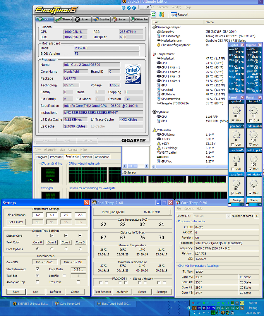

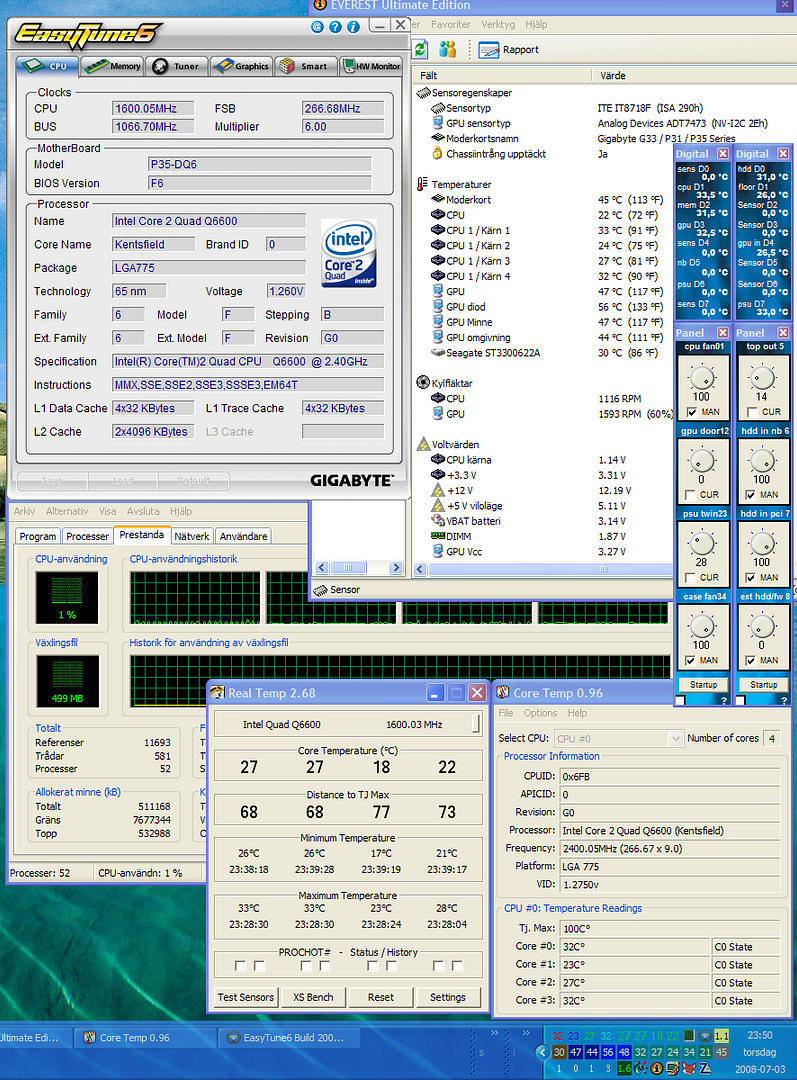

Here are some data from before and after RealTemp calibration
floor........ 24.8C ...digital indoor temp lying on the "floor" nearby the computercase
case out.. 26.8C ...holding a digital indoor temp in the "case out" airstream
(not a very precise method but it gives you an idea of what's going on :D )
Realtemp calibration - before
3-prime4x0-idle-0min-@1.6ghz6x266-1.1625v-mem800
http://i51.photobucket.com/albums/f3...z6x266-116.png
Realtemp calibration - after
3-prime4x0-idle-0min-@1.6ghz6x266-1.1625v-mem800-floor24.6c-caseout26.8c-cal
http://i51.photobucket.com/albums/f3...hz6x266--1.png

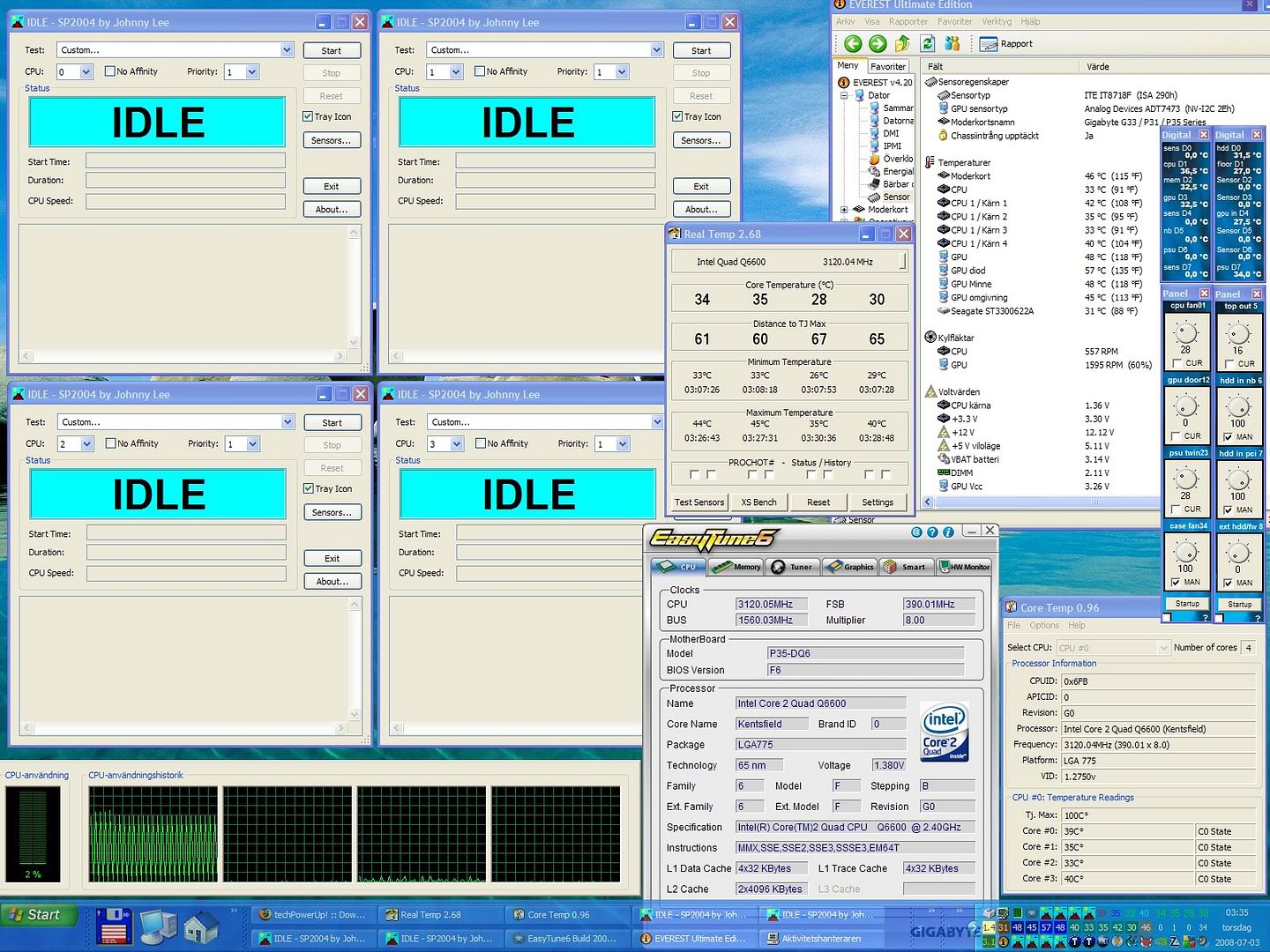

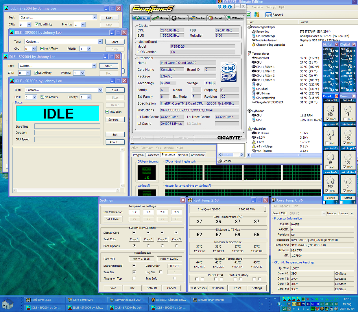

Q6600 2400@2300 speedstep 6x390
5-prime4x0-idle-0min-@2g3hz6x390-1v38-mem780-floor25c0-caseout27c9-cal
http://i51.photobucket.com/albums/f3...z6x390-1v3.png
Temperatures in C (idle)
Everest............... 39 35 32 38
......................... 39 38 32 35 (core order 0321)
CoreTemp........... 38 34 31 38
......................... 38 38 31 34 (core order 0321)
RealTemp............ 37 36 37 37 (core order 0321)

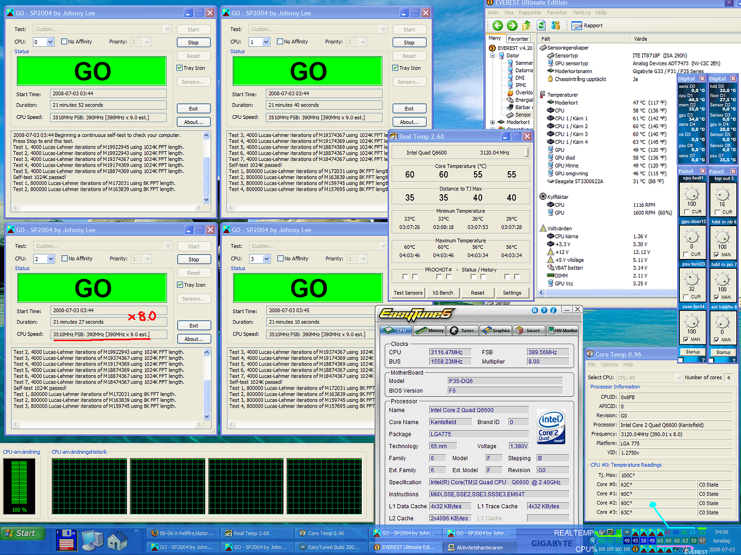

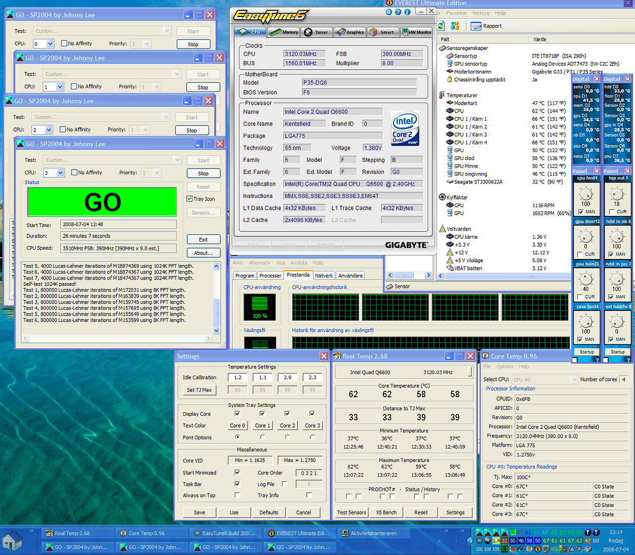

Q6600 2400@3120 speedstep 8x390
6-prime4x100-full-26min-@3g1hz8x390-1v38-mem780-floor25c0-caseout30c0-cal
http://i51.photobucket.com/albums/f3...g1hz8x390-.png
Temperatures in C (load)
Everest............... 66 61 61 66
......................... 66 66 61 61 (core order 0321)
CoreTemp........... 67 61 61 67
......................... 67 67 61 61 (core order 0321)
RealTemp............ 62 62 58 58 (core order 0321)

-X-hellfire: I'll need more time to thoroughly look at your data but here's a couple of quick answers.
I use SpeedFan to control my GPU fan. It has adjustable TjMax so at full load the temps are the same or very similar to RealTemp as long as you set TjMax to be the same.
Core VID is the voltage that a processor is requesting from the motherboard. There is typically two different values. A Minimum and a Maximum VID which RT2.68 now reports in the Settings window. Depending on your motherboard and how it is set up, Core VID can change between no load and full load. The main RealTemp window shows the real time reading of VID which can change. CoreTemp seems to be showing your Maximum VID.
The Intel documentation is a little fuzzy for VID so all programs may not always be in agreement.
There is also Core Voltage which programs like CPU-Z reports accurately on most motherboards. This is the actual voltage that the processor is getting. What a CPU asks for and what a motherboard decides it needs can be completely different and will change depending on if you are overclocking or not and how you have your bios set up.
In your case, things make sense. Your processor is asking for 1.1625 volts and the actual voltage that it ends up with after a little bit of voltage droop is 1.140 to 1.150 volts. Droop is normal and part of the design to keep processors from getting too much voltage during transition periods.
32C sounded like a reasonable number to shoot for. I'll have a second look at your data when I get the chance.
Core Order is something that RealTemp 2.68 is finally adjusting for. Many different core temperature monitoring programs, like CoreTemp, report the temperature data as is. The problem is that the physical layout of the cores is not always the same as how Windows sees the cores.
I consider a Core Order of 0 1 2 3 to be normal but I haven't got enough user feedback about this yet. In this case, when software asks for the temperature of core0 from the processor, it gets the temperature of core0 and when it asks for the temperature of core1 it gets the temperature of core1, etc., etc.
In your case, Core Order 0 3 2 1 means when software asks for the temperature of core0 it gets core0 but when it asks for the temp of core1, the processor returns the temperature of core3. 0 and 2 are OK but core1 and core3 have been swapped. I have no idea why this happens or what triggers the change from one order to a different order. My Q6600 was 0 1 2 3 for 3 months but now it has switched to 0 2 1 3 where the center two cores have been swapped. A few users see this sort of swapping very frequently.
Now that RealTemp takes this into account, you should be able to set your calibration factors once and never have to worry about changing them because your core order has swapped. It should take care of itself. Re ordering the data into the correct physical order also solves another problem where one day core1 is a cool core and then all of a sudden, nothing has changed but software is now reporting core1 as a hot core. This has been very confusing.
In your screen shots you will see that RealTemp has swapped core3 with core1 compared to CoreTemp. I believe that what RealTemp now shows better reflects the physical core order which never changes no matter what mood the operating system or processor is in.
Many 65nm Quad processors seem to have core0 and core1 that run 0C to 5C warmer during Prime small FFTs compared to core2 / core3. It might be easier to see relationships like this now that the raw data is being properly organized. Too many heatsinks have been remounted because of bad data and software that doesn't correctly handle core ordering.
Edit: I just noticed in the data that you posted that your core order changed during your testing from:
0 2 3 1 to 0 3 2 1.
Lucky you were using RealTemp. :D

Hey guys just a quick question i have a 8c split between the two cores on my quad 48,48,40,40(at load) but also the same split at idle. Is this normal. I have tried reseating the water block and adjusting the tension the the screws but this is the best i can get it (using fuzion v1 with standard mounting kit)
Brave758: Slightly different temps at full load from the two Dual Cores within a Quad is quite normal but I agree that your difference is on the high side of the Quads I've seen. Core0 and core1 almost always report higher and 0C to 5C higher is what I would call normal. I know on my Quad that I've seen as high as 8C or 9C but that's when I was doing some testing and turned the fan off on my Tuniq while running Prime. I don't have any numbers to compare to when running water.
Read the docs and do the calibration. When done properly, you should have pretty much equal temps across all 4 cores at idle and this calibration should also bring your full load temps much closer together.
nstarz: Don't make comparisons to what your motherboard software reports for CPU temperature because that data is not always accurate. Once again, read the docs and do the calibration. By temporarily lowering your MHz and core voltage you should be able to see if your sensors are both stuck at DTS=40. When you have temps that seem too high you have to try and force your temps lower any way possible to find out where the sticking point is. My E8400 also sticks but I didn't notice until I dragged it out to the backyard last winter to get it cool enough. Some of these sensors stick at higher temps but not very often at DTS=40. You also need to include your room temperature.

Edit: Here's a couple of screen shots of the weird things my Q6600 does.
With no heatsink on it and without using any calibration factors, the core temps are pretty close together.
http://img247.imageshack.us/img247/1...eatsinkba6.jpg
With a Tuniq Tower attached while running Prime with the fan turned off there is a huge difference in core temps between the two sets of cores.
http://img247.imageshack.us/img247/293/nofanfn1.png
I would have thought that having a heatsink attached would help to equalize the temperatures between the two sets of cores but here it seems to do the opposite of what you'd expect. The normal difference I see is more like 2C or 3C when running Prime small FFts with the fan on high and about 3C or 4C with the fan on low.
http://img152.imageshack.us/img152/8...allfftsqw4.png
All 3 screen shots are of the same processor so there is a lot of normal variation in the core temperatures in a Quad.
