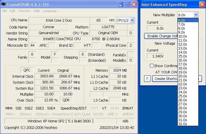

I didnt notice where to change the multi in the BIOS, am i missing it?
CPU tab, enable modify ratio support.
it should be under "CPU configuration" under the "Advanced" tab...if you do not have ratio support available to adjust then update your bios.
Or use cpuid to change it in windows.
http://img.photobucket.com/albums/v636/loc_oc/cpuid.jpg
Oh in the BIOS enable that option then :D Thanks

Hi loc.o i am just a newbie, but why you just did 12.65% overclock?
Hi and welcome :toast:
Not a particulair reason tbh, it just ran at 3ghz when i made the screenshot :D
