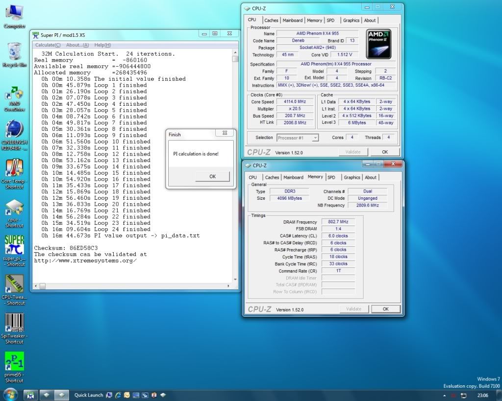

955BE 0915APAW watercooled.
Time sucks but it did 32M at 4.1GHz non the less. :)

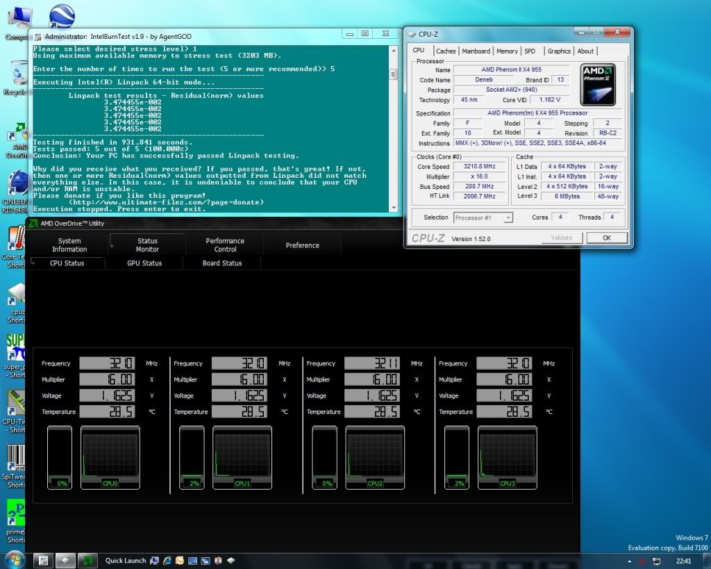

Can anyone explain why this cpu has a stock Vcore of 1.35V?
http://img.photobucket.com/albums/v6.../32GHz116V.jpg
This is even with a 64 bit OS which is supposed to be harder on the cpu stability, ie should require more vcore for stability.
Don´t know if i can replicate this with the stock cooler though, temps were only 34ºC full load, idle only dropped 1-2C° coming from 1.38Vcore.
