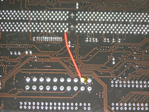

Same place as p4p800...Quote:
Originally posted by Rio71
oh, this is'nt good news. :mad:
but... how it works ?
you can try make the wires longer and connect it together after post is complete. :D
(but try this not with running win, memtest86 is saver if crashed or unstable...)
... i mean, the ovp is also "away-modable"... should.. :D
p4c800, i think is like the p4p800, whats the big difference between board to board.. ;)
I made the question cuzz the "normal" vdimm mod on these two boards are the same but in different places on the pcb of the board...
Definitely the same method like the one posted before on the p4p800 pic????
Same place on p4c800?
THKS IN ADVANCE!

So I only have to solder 1 wire on the back of my motherboard from the points shown in your p4p800 picture, from atx 3.3v to the vdimm point you show? I guess I should remove the "normal" vdimm mod I did in the past. Should I worry about the old vdimm mosfet or just leave it alone? Will the vdimm reading be from the same mosfet as before or do I read it from the socket? I think I may do this tomorrow.

hey VoRtAn_MaDgE, can you post an pic with the interesting area ? ;)
TyphooN, you want mod a p4p800 ?
only connect like the pic, thats all.
no removing... dimm-mod too..., the measuring-point you used is the same as bevor.
the fat red wire is needed, the longer smaller one is not needed, but helps a little little bit.
conclusion: only two solder points. :D

Alright, that just makes it easier for me(not removing the old mod). So basically the vdimm will be the same or slightly lower as 3.3v correct? I won't need near as high a rail as I am using now(3.62 to keep 3.3 stable).
if your 3,3v actually 3,62v so the vdimm come close to 3,62v and 3,60v under mem-load, memtest86 #5
the success is depending of thikness of wire. use a fat as possible (massive wire).
Alright, I think I have some thick wires, from an old psu. Thanks for your help =]
I did this mod last night. It works awsome. I just wish I could turn down my 3.3v some more, the lowest I can get it to is 3.5, and I do not need that much vdimm for how fast I am running it. I hope it isn't bad for the ram.
