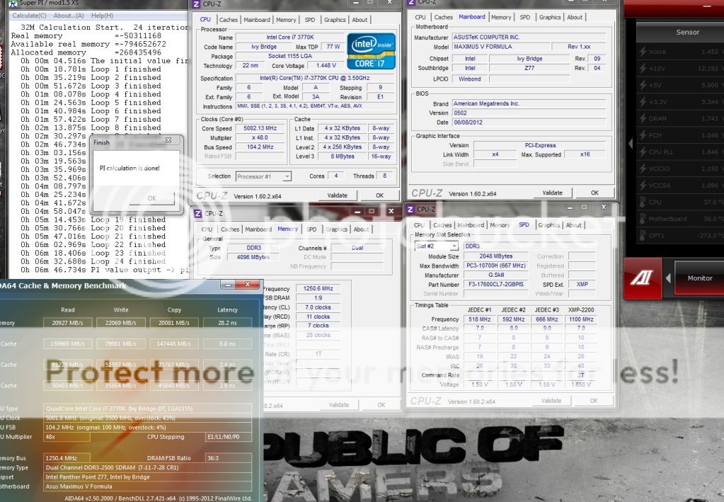

G.Skill Pi 2200C7 2X2GB F3-17600CL7Q-8GBPIS
http://i458.photobucket.com/albums/q...Y/DSC_0349.jpg
2500 7-11-7-28-1T @ 1.75v
http://i458.photobucket.com/albums/q...25007-11-7.jpg

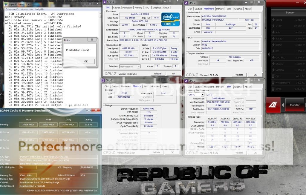

yeah indeed they are awesome sticks & rarely can find nowadays. more tests...
2000 6-9-6 @ 1.65v
http://i458.photobucket.com/albums/q.../20006-9-6.jpg
2600 8-12-8 @ 1.92v
http://i458.photobucket.com/albums/q...26008-12-8.jpg
