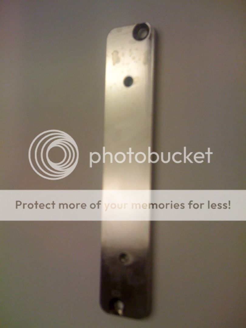

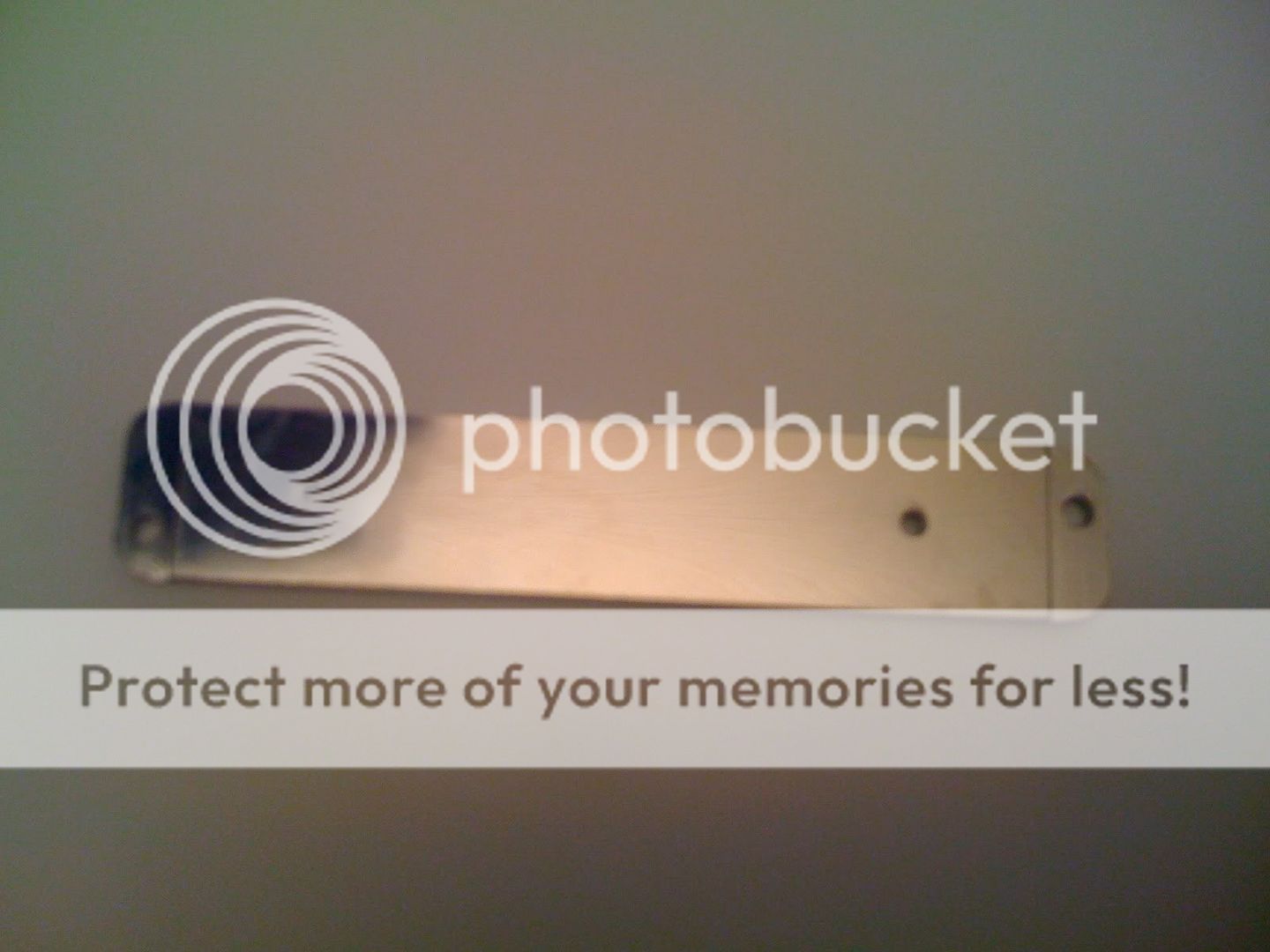

One last observation... I get continuity between the inductors to the left of the socket and the surface of the NB... Is that normal?
This happens both in the dead board and in the non-dead one...
I'd have thought that the surface of the NB would be non-conductive?
http://i547.photobucket.com/albums/h...i/IMG_0128.jpg
http://i547.photobucket.com/albums/h...i/IMG_0126.jpg
its not installed pic but just a backplate, sorry for the bad quality pic

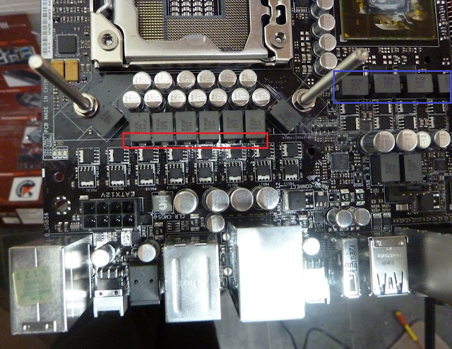

hi guys, i have to share something,
in my case, i just cover all those chokes that shown in the picture the red and the blue rectangle box
http://lh5.ggpht.com/_3CUeOKFhLdY/TP.../s640/mb20.jpg
i wreck 3 genes just to figure out this thing, and also be careful tightening the block the blue rectangular choke might crash

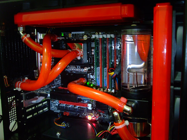

and here's my rig 100% after wrecking up 3 genes :)
http://lh6.ggpht.com/_3CUeOKFhLdY/TP...916%5B1%5D.JPG
Awesome! Now we are getting somewhere! Looks great Februariusx! Love the colors you chose for your tubing!

Seems this block has a major design flaw. at least 3 people have killed boards in this thread... 2 of them 3 times each. I think I will stay away.
If the block touches, or comes close to those chokes, and that is how it is shorting, then it should have areas in the block cut out for the chokes for better clearance.
any marks on that chokes? burnings or smth? i thought that problem in NB power circuit (blue rectangle) but i blame MOSFETs (in my mind)...
PS: love the color scheme of LC loop. must be pumping blood :) and i notice tubing going out of the case: more rads outside?

actually the choke will break some a little or some cracks, the chokes house was made of metal, this tiny powder piece can able shorts the mosfet belows it , you notice that while you tightening the block you heard some cracking sounds thats the choke breaking it housing apart

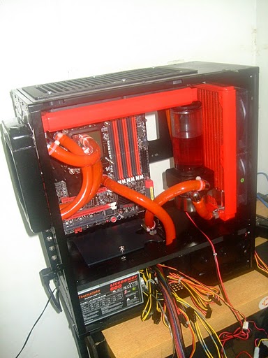

here the exact idea, but it couldn't accommodate dual hdd for raid 0 setup, so i remove 140 rads at the bottome
http://lh3.ggpht.com/_3CUeOKFhLdY/TN.../DSCF5626s.JPG
@februariusx
5x120 sections for cpu+mobo loop :shocked:
is there MORA-3 "in cart" when You'll add GPU block:ROTF:
nice build

@ februariusx, what case is that?
