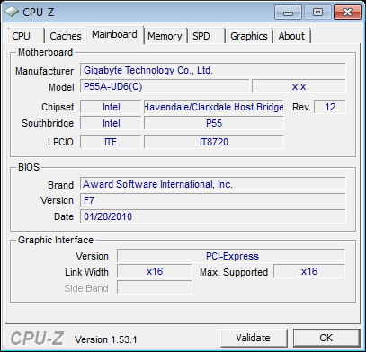

okay note for clarksdale. The f6 bios at the top of the list on page 1 is no good. you want the f7 bios for ud6. f6 sets my x16 at x8. I came across this same issue on msi gd65. they gave me a beta bios 1.73 but bclk on that board with clarks maxed at 200 on dice so I sold it and bought the maximus III formula and and a ud6. I just insulated the M3F. now I'm gonna pull the ud6 off (im curretly on it typing this post) insulate it and hopefully by that time I have a decent bios to work with. in the meatime Ill see what I can do on F7 bios.
http://i239.photobucket.com/albums/f...clarkud6F6.png
http://i239.photobucket.com/albums/f...ith/f3bios.png

Guys,please check this updated version:
CPU-Z 1.53.2
-fix CAS for Clarkdale
-released 15.02.2010
This is internal beta version and without validation.
working great here.thanks stasio for your help with this issue
