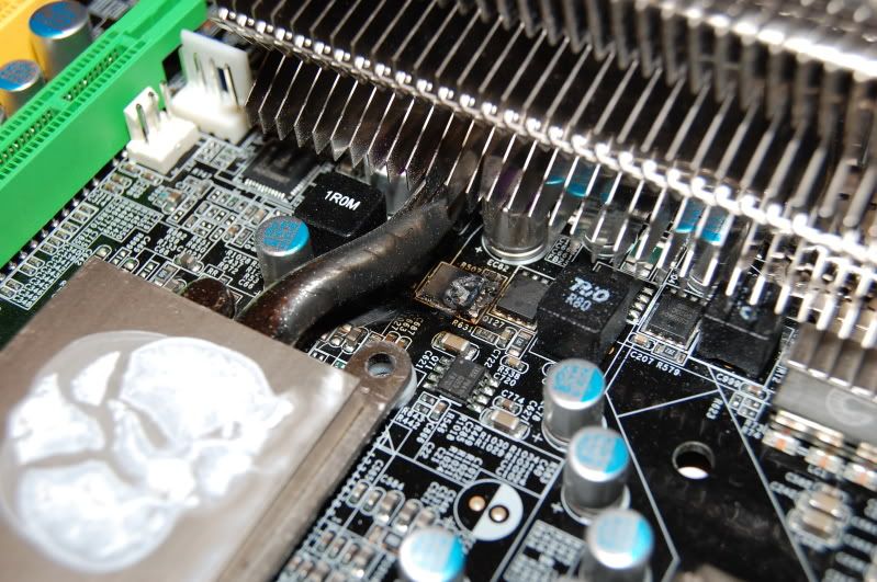

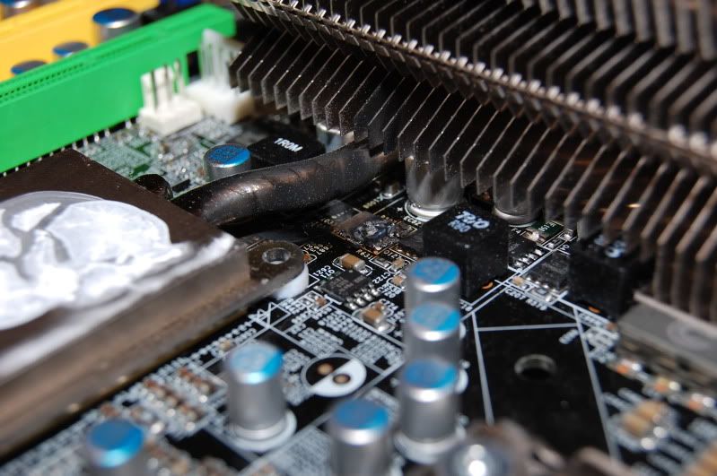

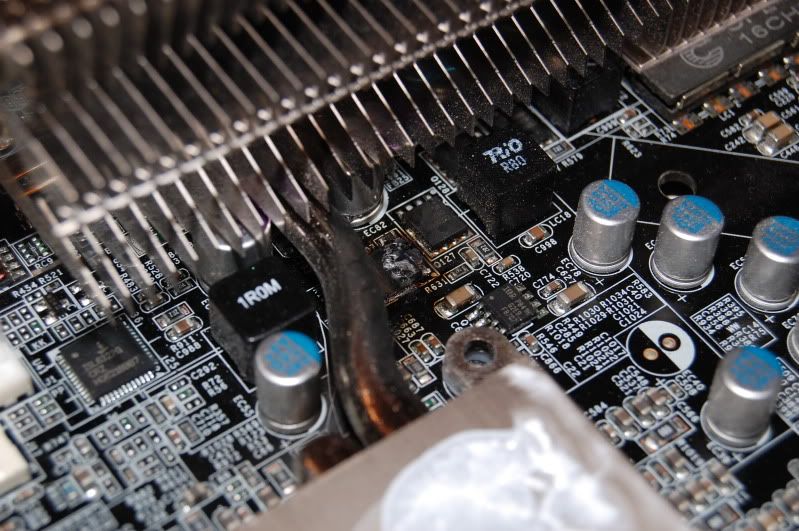

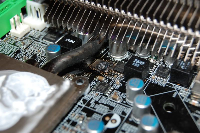

Picked the board back up from Jimms to get some more pictures for DFI. Removed the NB heatsink to get a better view:
http://i377.photobucket.com/albums/o...n/DSC_0542.jpg
http://i377.photobucket.com/albums/o...n/DSC_0543.jpg
http://i377.photobucket.com/albums/o...n/DSC_0544.jpg
http://i377.photobucket.com/albums/o...n/DSC_0545.jpg
http://i377.photobucket.com/albums/o...n/DSC_0546.jpg
What is that I'm seeing just under heatpipe (looking at board right side up) near NB heatsink? Is it blown capacitor? Could you take a picture from down side up?
EDIT: Sorry, it is probably end of the other heatpipe (SB to NB), but it looks kinda brownish. Just strange falling light a suppose. I should wear thicker contact lenses. :D
When I take a better look at those picture, you should sent it for repairs, as it looks like board is not damaged, just top of that IC, but wait for more comments now that there is more pictures.
All pictures are of the same spot on the motherboard, between NB and PWM.
Thanks for posting those pictures Woffen, that makes it much easier to know the extent of the damage. I'm not an electrician (but many members here are) but if that component was the only damaged part it seems like it might be possible to just fix it yourself (or by another more capable member) by replacing that component? There looks to be only 8 contact points (4 on each side of the component) so it looks possible? Then again if the issue lies with other components on the motherboard and this just happened to be the noticeable symptom of that issue than replacing it might not fix anything? Hopefully as more knowledgeable members view those pictures you'll get more articulate answers about the possibility of getting it fixed?

The photos have been received. After having a small "conference" with my repair techs we have decided that the damage may be more superficial then it first appeared, and at the very least you deserve a chance. We are willing to attempt a repair of the board. There are no guarantees here thou, and this doesn't reflect a change in policy. It reflects giving someone a fair chance. I shall be in further contact with you via Email.
