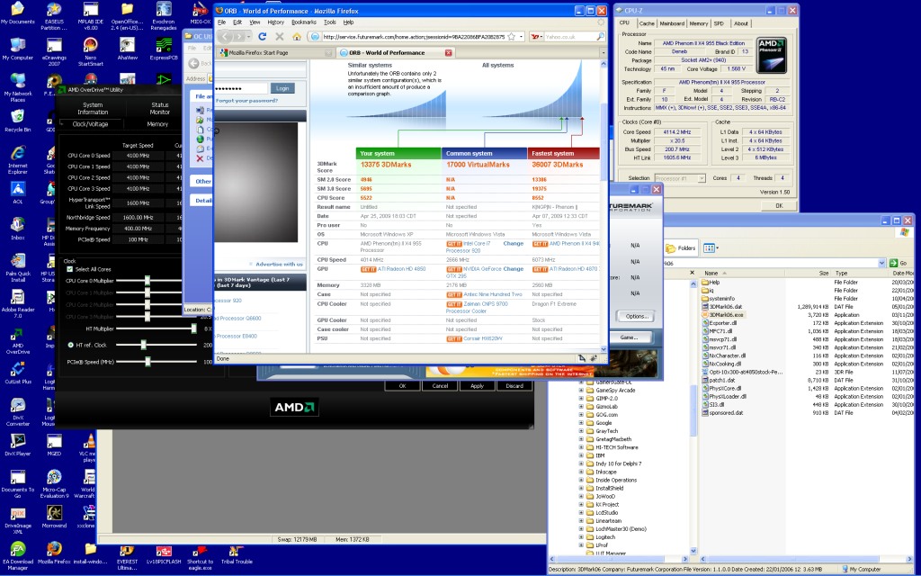

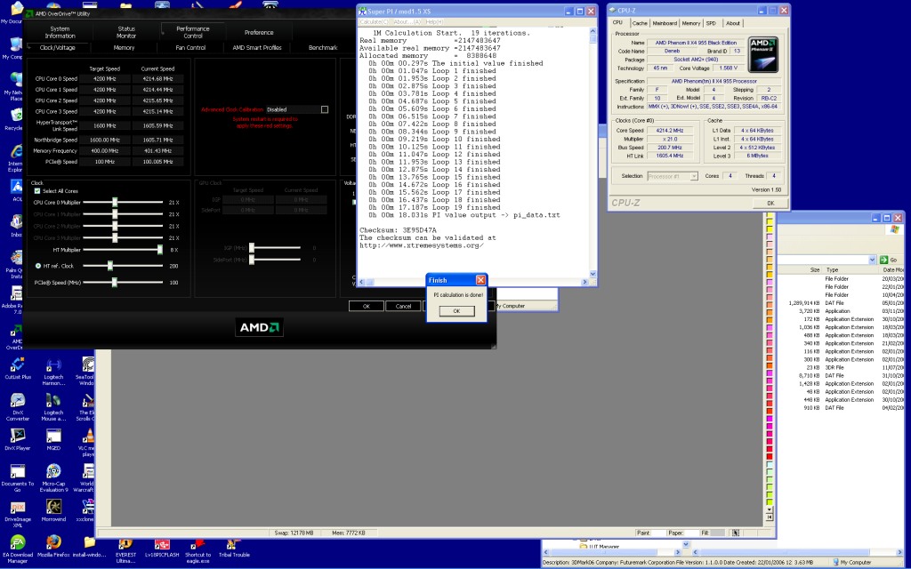

I must admit this cpu is a lot more fun now I'm using a power supply that's up to the job. Apologies to AMD for all the nasty thoughts, it wasn't your fault at all. So, a bit of brute force, some chew* magic and ...
http://www.i2net.me.uk/files/Overclo.../955PI@4.2.jpg
http://www.i2net.me.uk/files/Overclo...ay/955@4.1.jpg
I'll work on subtlety later :D
Question:
Why does 3d06 show my clock @ 4.0 when it was run @ 4.1 ? I checked it twice :( I ran one previously at 4.0 but that was many crashes ago.
