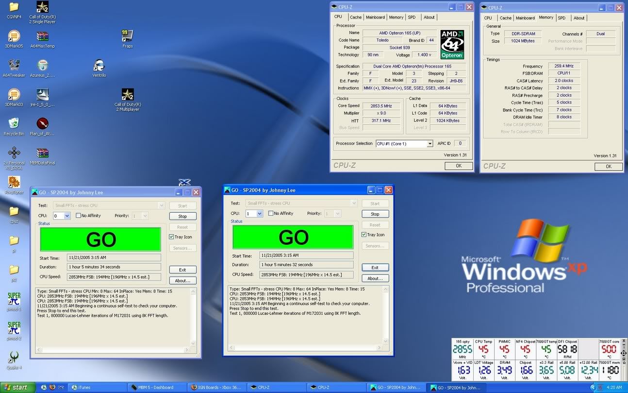

Heres a screenie to go with that CPUz validation:
http://i26.photobucket.com/albums/c1...Wreck/3gPI.jpg
Again, is it dangerous to dual prime at 55c load?

AFI.....you get an RDX200 or something? CPU-Z is bugging out with your voltage.
Anyway, good to see that beast climbing :up:
Why does CPU-Z say 1.4v and mbm says 1.63v?
Hey I just realized that, weird... I have 1.6775 set in BIOS (1.525 VID 110%) My other CPUZ window (the one showing ram) detects it the same as speedfan... Silly CPUZ :p:
afi, be careful with those voltages if you're using a dfi (non-expert) nF4. The vcore may be jumping considerably (.05V) under load. Voltages appear to be much better regulated with expert.Quote:
