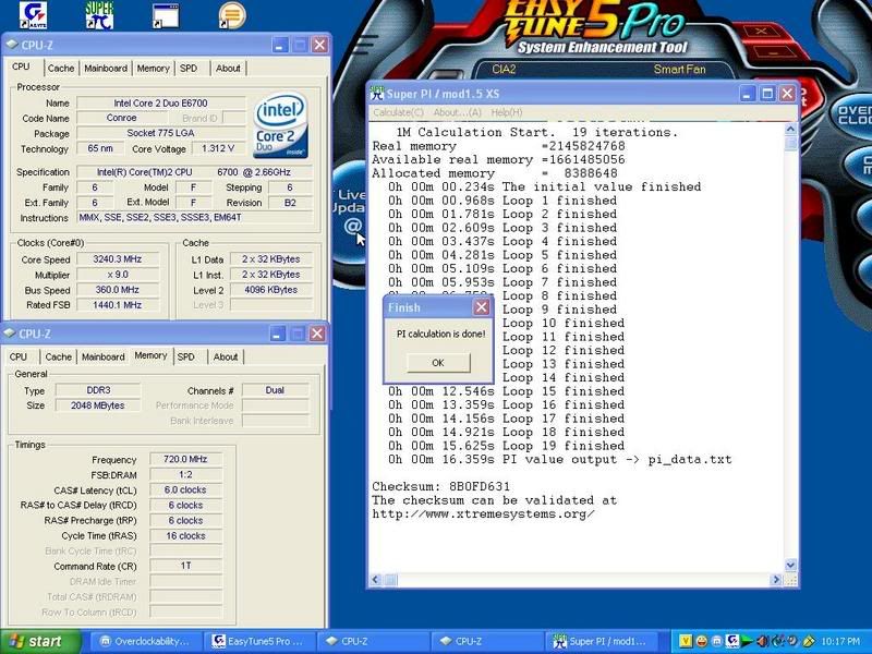

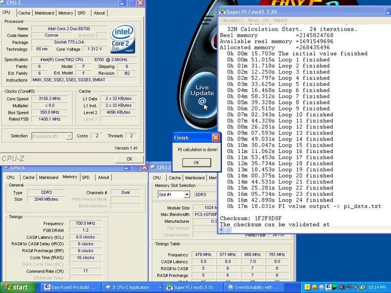

I have it yesterday, X38T-DQ6, just a quick test with GSKILL F3-12800CL7D-2GBHZ, also flash two bios F3g and F4a, bios F4a is terrible
700@6-6-6-16 . Pi32MB
http://i220.photobucket.com/albums/d...205v-PI32M.jpg
720@6-6-6-16
http://i220.photobucket.com/albums/d...6-6-16205v.jpg

http://img444.imageshack.us/img444/3482/maxfsbji3.jpg
All Auto (just Strap @ 333).
