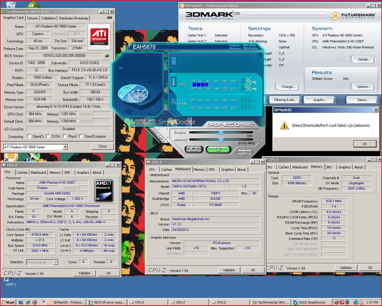

I'm not running crossfire, But i am running a 5870 and i can produce the same error as you have stated. As soon as the error hits the system will restart. I can open as many CPU-Z windows as i like without a hitch. My HT-Flood errors hit when i do any hard I/O task. I have 3 systems with this hardware and only one does this. I have not had the error since flashing to the newest bio's revison.

http://i262.photobucket.com/albums/i...-5870error.jpg
Im not sure what causes this problem. Anyway I posted quite a few bench test results in this thread earlier with the GD70 and the 1090T Thuban but I was running two 4870x2s quadfire. No problems with the system what so ever. I had seen the sync flood error message at the end of post just before the system loaded the OS but that was very rare. I could do just about anything I wanted as far as clocking the GFX card or about anything else in the system.

I dont know it the sync flood error or whatever problem causes that error is the problem with my system but there is a problem. I also dont know if I did a clean install of the OS and everything else if that would fix it or not?
I seen the sync flood error message after the GFX upgrade. The system either drops to the desktop during a bench test, the screen goes black, it crashes then reboots or as in the above SS during 3D05 the screen goes black then sets that error message. When the message appears I can tap the Esc key and return to the desktop. Usually I get a bunch of white pixels on the screen as the bench test locks then sets the above error message.
This happens at default or mild GFX overclocks. All the above problems are with only one 5870 installed. When I install the 5970 or the 5970 and the 5870 together some bench tests such as vantage wont even start as the system just crashes then reboots. Im using the Corsair 1000W PSU and I dont see it as being the problem.
All the above problems happen during the graphic part of the bench tests not the CPU tests.
I am using the latest bios on the MSI website which I flashed after first trying the GFX cards with the beta bios.
I may pull the cards and install them in the Asus Crosshair III to see if the problem still occurs.
Thanks for confirming the HT sync flood issue.
