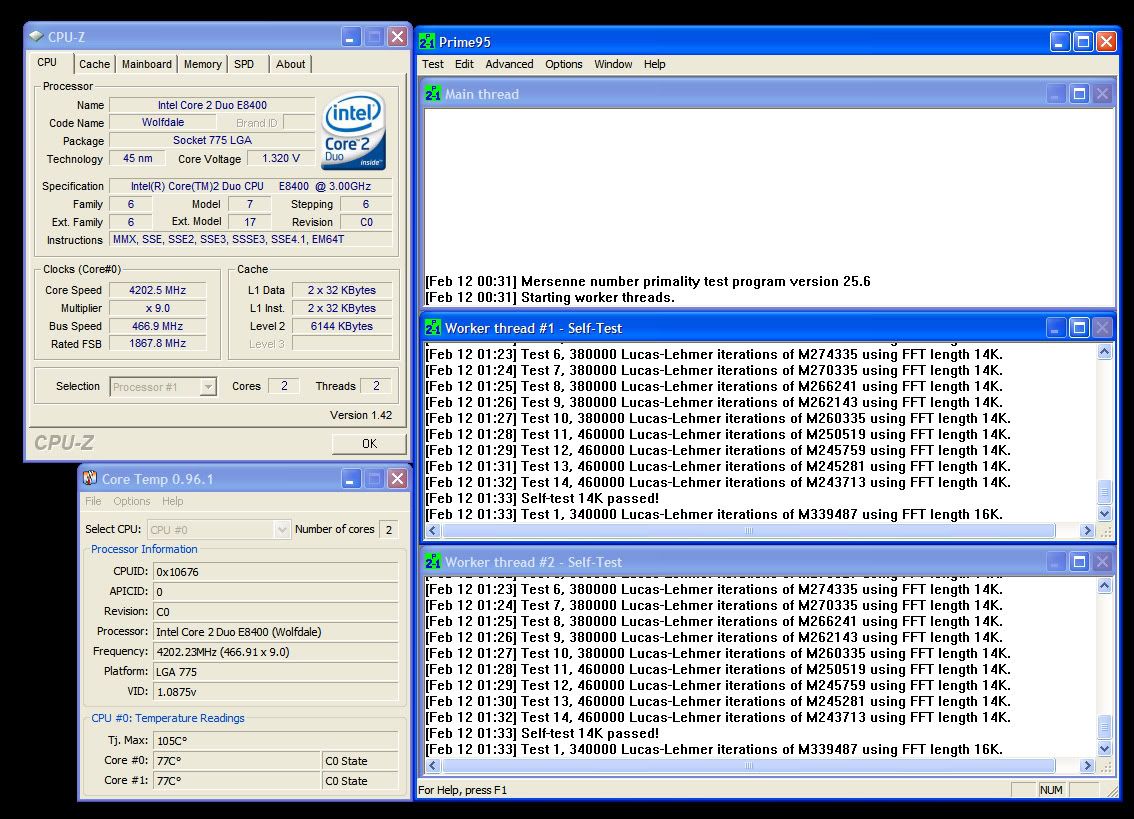

My final overclock with a broken sensor.
http://i51.photobucket.com/albums/f3...an/4200mhz.jpg

zizo: 4202MHz @ 1.32 volts is excellent. Maybe you could add a picture to the Wikipedia and show the world what a grade 'A' E8400 looks like! :up: What's your date and batch code (Q7--A---) printed on the top of your processor or from your box? I've run my E8400 at 4200 MHz but to be Prime stable instead of needing 1.32 volts I'm probably going to need about 1.42 volts. I haven't decided whether I'd push it over 1.40 volts for 24/7 use. Probably not.
