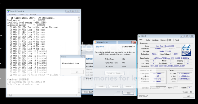

Any of you have settings for a 4ghz Q9550 ?
A cpuz verification and a burn test stable and all screenie proof..
Im planning on getting a Q9550 for this workhorse..
Thanks!
http://i392.photobucket.com/albums/p...erson/quad.png
Probly the best I can do with the aging P35 :(
Danged thing wont reach OS on 3.9ghz lol.
btw, Is 1.368v high for the clock?
:p: Yes you are very correct. 455 was my tops (and would require 1.55 :mad: the nb volt which makes the pci-ex run @ 1x forcing me to lower the oc back to where 1.4v nb oc area :mad:)
Frackin board and its 45nm quad handling. Time to get me one of them p45 (that DFI p45 jr is going for 150 dollars here and I got this Q9550 2nd hand which only costs 180 dollars. Pretty much cheaper than going to a bnew i5 and ddr3)
