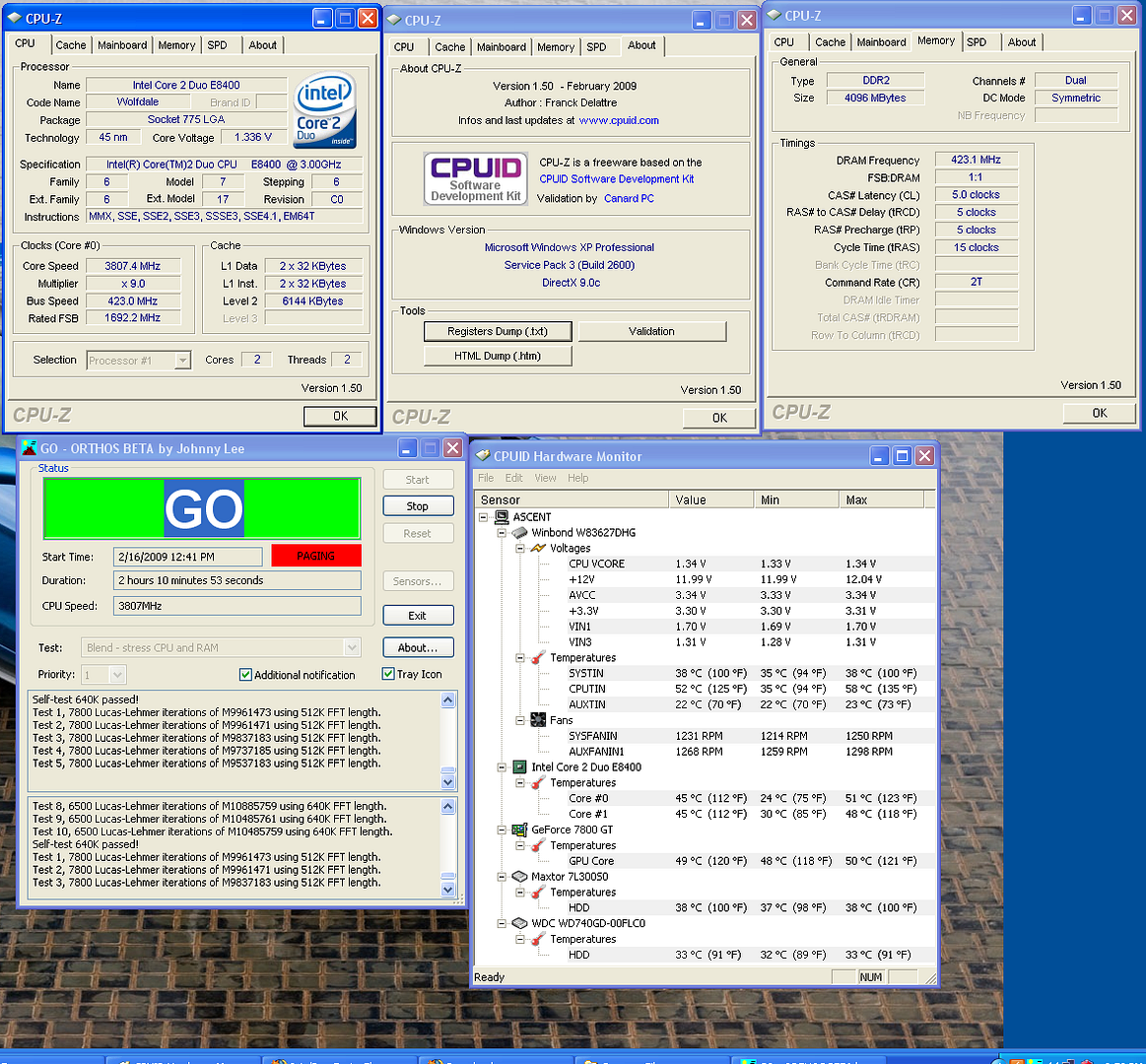

Right now I'm stress testing my E8400/C0 1.33V BIOS 1.28V CPU-Z w/P5Q-E at 400 FSB 3.6Ghz CPU memory G.Skill 2x2GB at 1:1 400 Mhz and I've hit 62 degC on Core0 and 59 degC on Core1 after only 10 min of P95 blend.
Should I try for 3.8 Ghz?

Two hours into 3.8Ghz, no errors...
Okay, I'm 2hr of P95 and IBT stable with these settings, from PakaPake, Thanks. I can boot Windows at 4Ghz but after only a few seconds P95 fails. IBT loaded both cores to 60 C, surprisingly much higher temps then P95, but my temps seem to be good.

I'd like to try for 4Ghz stable. What should I do next? Just keep bumping Vcore? Should I also bump NB voltage, or any of the other voltages? Any help would be appreciated. Thanks!
