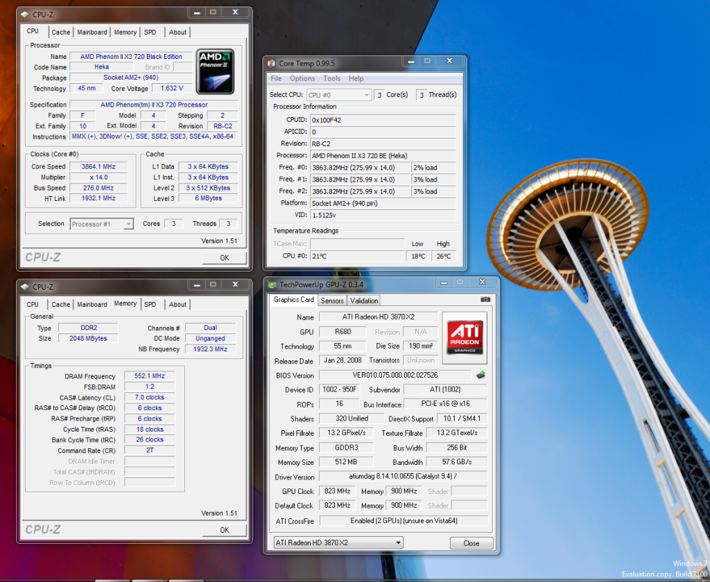

I have run 1200+mhz with the 720 @3900/2700nb on this Mobo Easy..PatriotViper can be very fussy too . @ 4'ghz 2200nb i run 1157mhz on the ram. I run my Ram very loose then tighten up things once i get my Max clocks i want to use.
720 using X20cpu multi and 1066divider.
803BIOS
http://i168.photobucket.com/albums/u.../anew720be.jpg
720 using 18.5cpu multi 217 htt and 1066 ram divider for 1157mhz ram.
902BIOS
http://i168.photobucket.com/albums/u...ios4014mhz.jpg

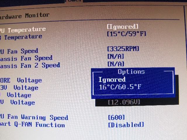

Last make shure you Disable Temp Monitor and VcoreVoltage. or youllg et boot warnings in all Bioses.

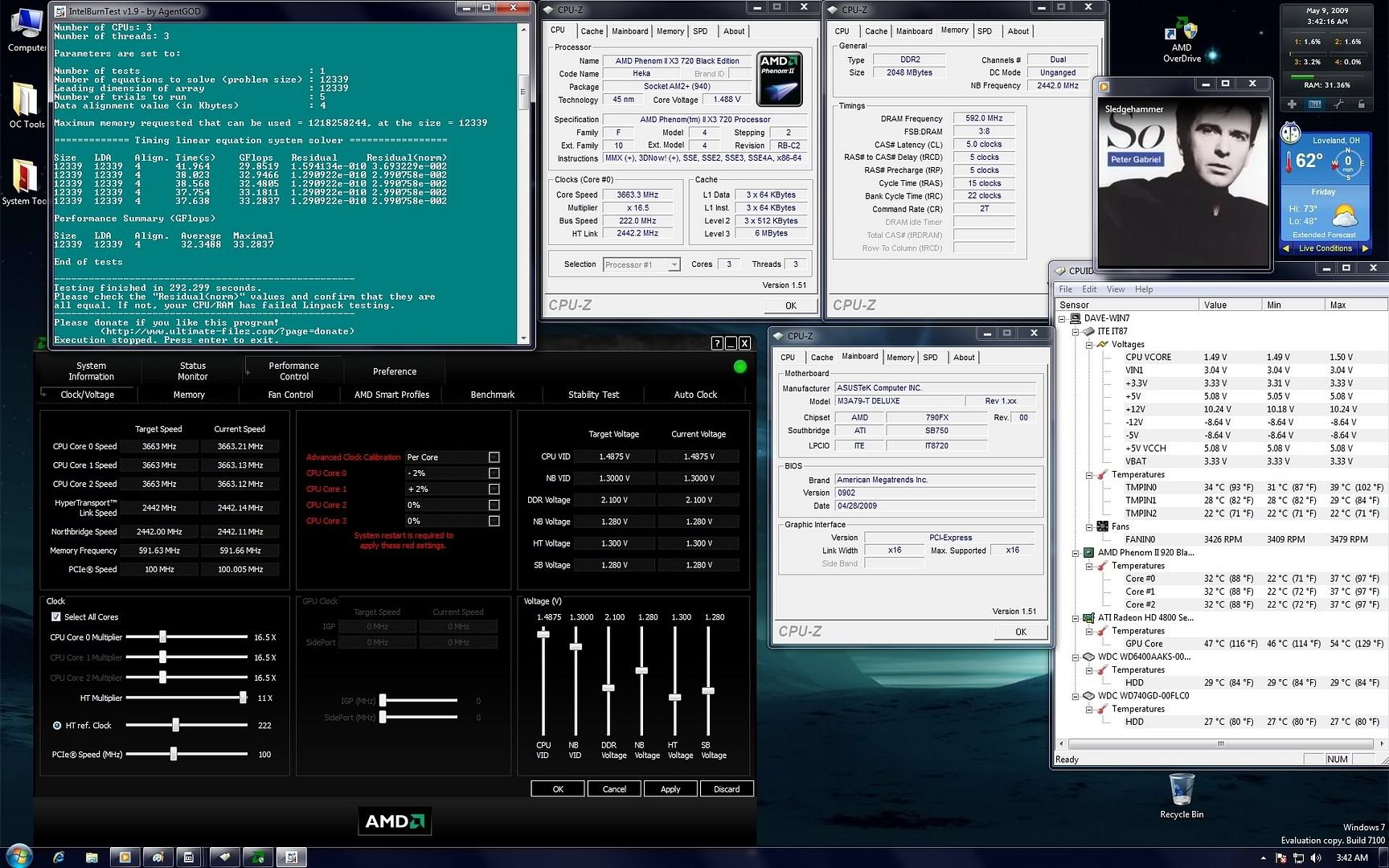

Sorry for the big SS, but this 720 is a killer chip for $140 and I wanted to make sure it was readable...
I really tried to push the memory this time and it did quite well! Almost 1200 Mhz on DDR2 with pretty tight timings... :)
http://i30.photobucket.com/albums/c3..._MaxStress.jpg
Maybe I'm easily amused, but I was pushing the system REALLY hard...
Five pass IBT, listening to some tunes, surfing the net and checking E-mail with all the sidebar apps running at the same time...
Nice IMC/HtRef clocks too, and the V's are within reason with sweet temps...

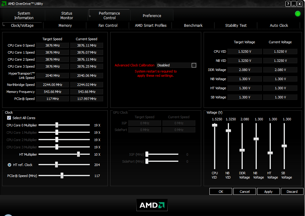

I put the 940 back on the Asus today and I thought I'd push it a little harder since the new 902 bios is installed.
I'm running into a problem I haven't experienced in quite awhile. It starts with little sparkles (video corruption) on the Win7 load screen and sometimes during regular operation.
I've had this happen before and bumping up the HT voltage has ussually gotten rid of it although I've never had to go over 1.3v to fix the problem.
The bigger problem is LOUD OBNOXIOUS audio corruption! So bad that it scares the hell out of my cat (and me too)... :shocked::D
I've had the noise problem happen before as well, but I could never figure out a way to fix it other than just lowering the clocks.
Seems like these 2 things may be related, and could very well have something to do with the HTLink (or SB voltage). Does that make sense to anyone else?
I'm kind of a wimp when it comes to just throwing voltage at a problem unless I know I'm throwing it in the right place.
Does anyone have any idea what may cause these symptoms and what the solution may be? Or have I just reached the limits of what my system/chip can handle..
Heres an AOD SS of my current setting (with the 79-T ov actual core is 1.54):
http://i30.photobucket.com/albums/c3..._AODStress.png
Disable auto express in the bios, 117mhz on the Pcie is a little high IMO. I have noticed Video corruption when its running too high.
