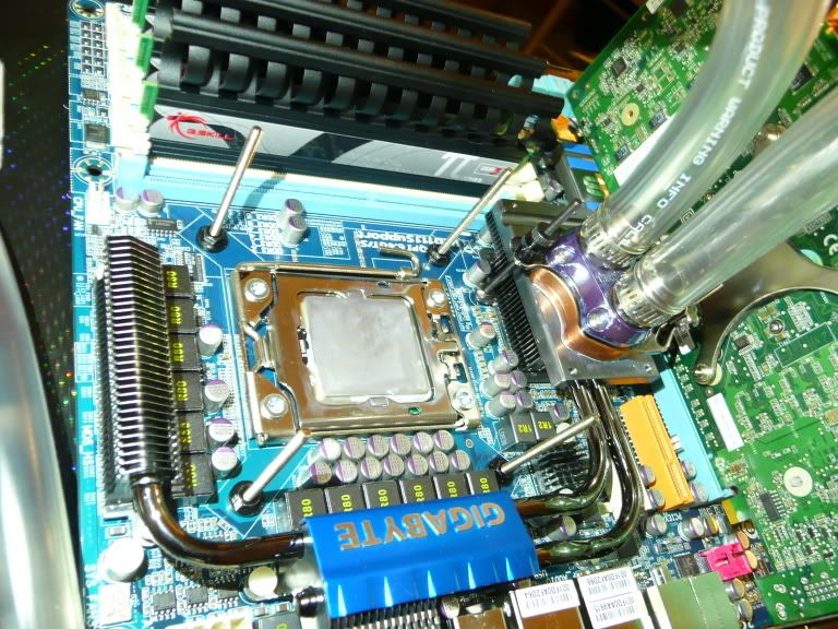

if you wanna watercool the nb
http://i24.photobucket.com/albums/c5...5/P1010992.jpg

Don't think the NB needs watercooling mate, I still use the Antec spotcool to blow fresh air over the rams and the NB... will report later with temps
http://users.telenet.be/OAP2/swiftech.JPG
I know on my eclipse the motherboard value was something else much cooler than the NB.. the NB ran about 57c idle. anyways.. I see the extreme has a HUGE cooling apparatus if you go air only.. so I am betting the NB temps will be pretty good on air. So I'll be picking that one up I guess since I like to give my local shop the business for the new mobo. Thanks for the info RM! This thread appears to have all I will need to get things tweaked initially. That's another reason I want to go with the EX58, because of the strong following here. :)
Leeghoofd - thanks! the extreme version has a water block on the NB already, but is also has some additional cooling parts you can put on if you're going air only.. so I will use those with a spotcool. cheers!
