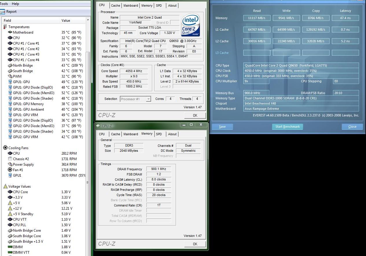

big thanks to zlojack & Kensek my Q9650 is now @ 450x9 :)
cpu: Q9650
Ram: 2x1gb OCZ FLEX II
FSB Frequency: 450
CPU Ratio Setting: 09.0
CPU Clock Skew: Auto
NB Clock Skew: Auto
FSB Strap to North Bridge: Auto
PCIE Frequency: 100
DRAM Frequency: 1801Mhz
DRAM Command Rate: 1N
DRAM Timing Control: Manual
CAS# Latency: 8
RAS# to CAS# Delay: 8
RAS# Pre Time: 8
RAS# ACT Time: 20
CPU Voltage: 1.281
Load-Line Calibration: Enabled
CPU PLL Voltage: 1.51106
FSB Termination Voltage: 1.10016
CPU GTLVerf (0): +70mV
CPU GTLVerf (1): +70mV
CPU GTLVerf (2): +70mV
CPU GTLVerf (3): +70mV
NB GTLVerf: +60mV
North Bridge Voltage: 1.51097
DRAM Voltage: 1.86881
NB DDRVref: Auto
DDR3 ChannelA Vref: Auto
DDR3 ChannelB Vref: Auto
South Bridge 1.5 Voltage: 1.51106
South Bridge 1.05 Voltage: 1.06039
CPU Spread Spectrum: Disabled
and now i just want to check with you guys if all my voltages are is the safe side, and also how to get CPU GTLVerf values, i remember it has something to do with the VID my CPU VID is 1.2375 so can anyone help ?
