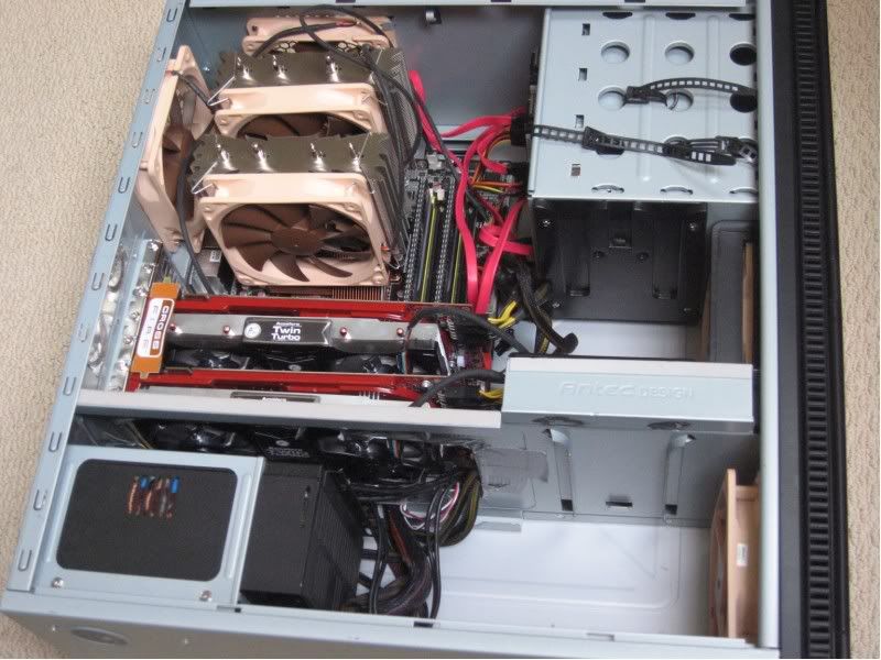

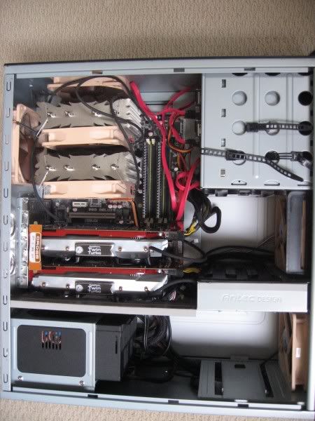

I have a crossfire HD4870 setup on my board: great GPU performance in gaming with the CPU overclock too, but I struggled with the heat and noise in normal day to day computing
I replaced the stock coolers with Accerlero Twin Turbos (which fit a variety of GPUs). Much better coolers: less noise and much lower temps/noise in normal computing
http://www.arctic-cooling.com/vga2.php?idx=166
This is just a headsup that they work on the P5Q board in a Xfire config, just fit
Couple of snaps here, had to mod an Antec P182 case slightly to get the lower cooler mounted - cut a hole
Yes there is duct tape there to stop cable fray on the edges :p:
