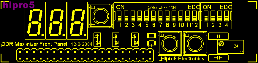

NOW.........This is the "final release" of the front panel.......Some changes where done so as to "cover" everyone......
http://www.thelab.gr/images/Hipro5/T..._final_png.png
As you can see there have been placed THREE more swiches ON-ON and three DUAL leds..... :D
The switch between the Led Displays and the dipswitches is for : PUSH ON = DDR2 support - PUSH OFF("on" in real) = DDR support..... ;)
The dual led below it will show the configuration of it......PUSH ON = Red , PUSH OFF = green.......
The other switch below the dipswitches(left one) , is for VTT ON and OFF......For mobos which can track the VTT , should be OFF and for mobos which can't support VTT(ex. ABIT IC7) should be ON......You can leave it to ON with no harm at all even for mobos which can track the VTT.......
The middle dual led is RED when we have PUSHED ON the VTT switch and green when this switch is in OFF......
The right switch (next to trimmer) is for : When ON = dip swiches working - When OFF = Trimmer working.....
Another dual led is placed for indicating that.....When ON = green for dip swiches (aka = safe :) ) and when OFF = red (aka = danger :) )......
Voltaged via dip switches for DDR are :
2.85 - 2.90 - 2.95 - 3.00 - 3.05 - 3.10 - 3.15 - 3.20 - 3.25 - 3.30 - 3.35 - 3.40 - 3.45 - 3.50 - 3.55 - 3.60
Voltaged via dip switches for DDR2 are :
2.25 - 2.30 - 2.35 - 2.40 - 2.45 - 2.50 - 2.55 - 2.60 - 2.65 - 2.70 - 2.75 - 2.80 - 2.85 - 2.90 - 2.95 - 3.00
Voltaged via trimmer for DDR are maxed out at 4.1Vmem(Vdimm)
Voltaged via trimmer for DDR2 are maxed out at 3.5Vmem(Vdimm)
How it looks???........DON'T ask me to add anything else on it coz it's just "full".......no spare place on the PCB anymore...... :D

One thing I have forgoten though.......Another switch ON-ON for picking either led displays to show Vmem or VTT........I'll fix it ...... :D
