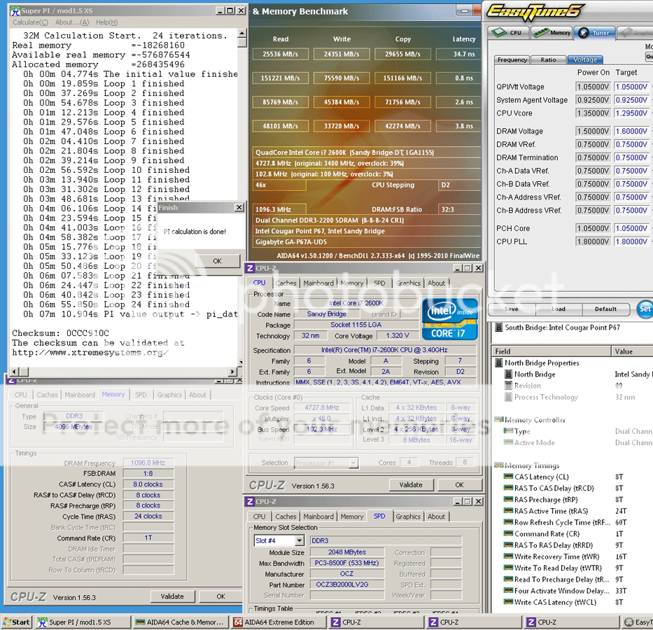

1067mhz 8-8-8 tested an hour Prime 2.64 3.5gb @ 1.05v/1.58v
7-7-6 also ok 32M 1067mhz 1.76v which is ~0.03v higher than same clock on my 920/e760
here's a vista 32m 8-8-8 1097mhz
vtt 1.05v set (1.08v cpuz 156)
vdimm 1.60v set
i set trfc 60, all other subs auto which do look slack for hyper
http://i447.photobucket.com/albums/q...04_OCZ_F6D.png
looking very much forward to your super pi runs :up::up::up::up:

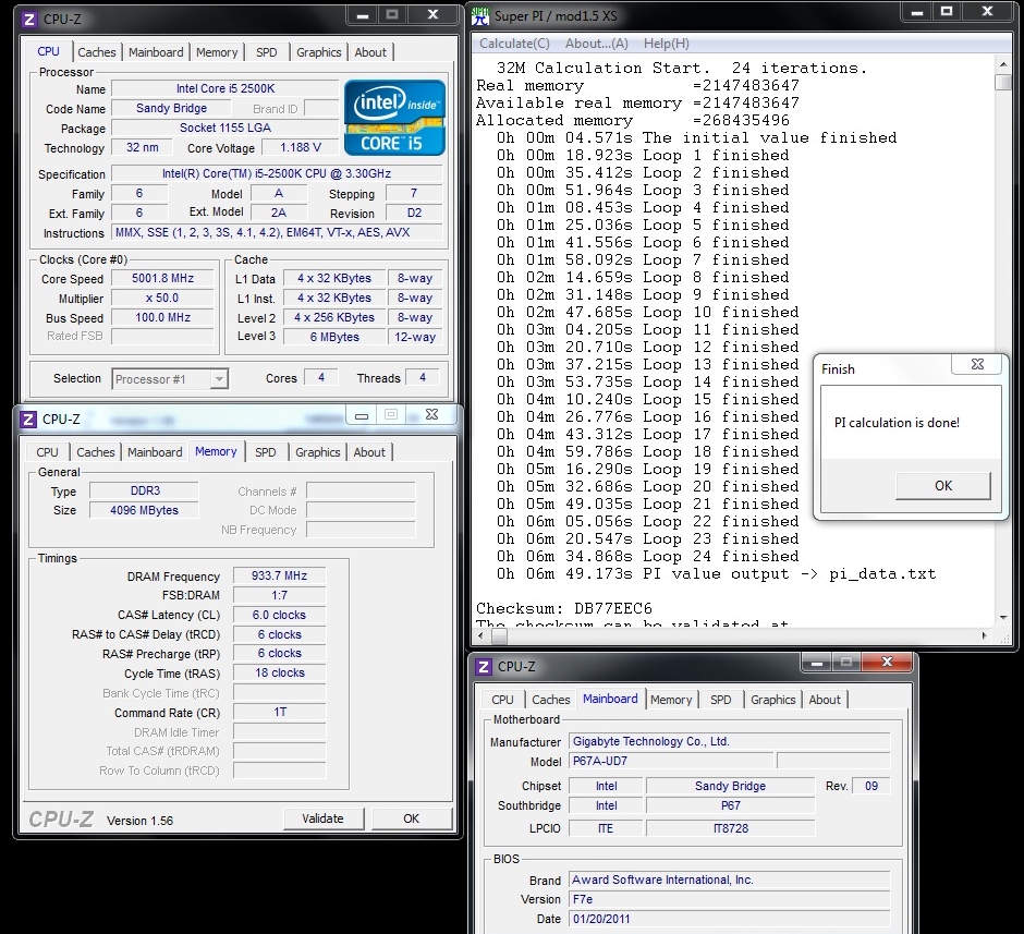

Yah noticed that to dino, still curious as to what is needed 6-6-6 wise, I wasn't fully dialed in for that run.
Really need a chip that does 5.1 for some 5 gig high speed 6-6-6 runs so i have bclk flexibility.
I did get a run off at like 1940 4.8 but to keep my performance table in line it needs to be run at 5 gig.
I think 50% of the fast hyper run came from ability to run 58 TRFC versus the PSC topped out at 68..... the rest was in the subs.
