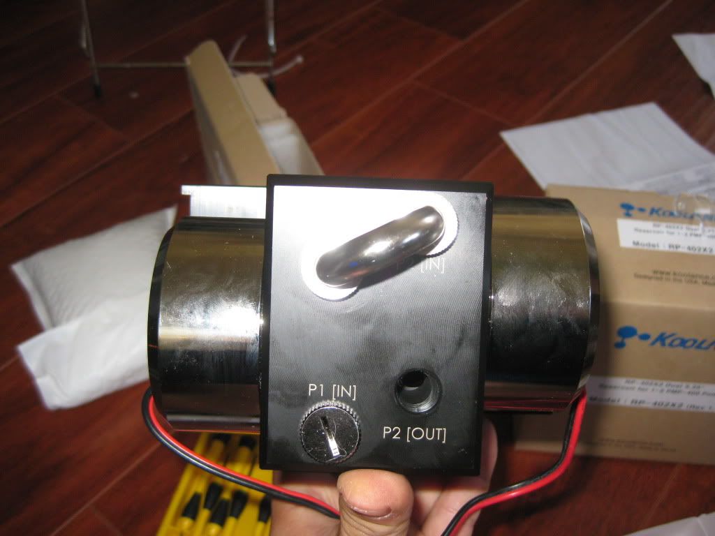

Guys direction says we need to mount it like this:
http://i125.photobucket.com/albums/p...S/IMG_0691.jpg
makes sense because its the only port with 3 screws.. however... lets think about it from a flow perspective... this doesnt help the right side...

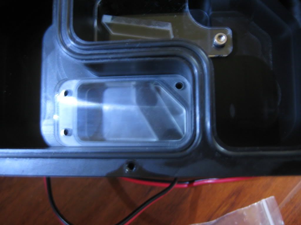

So you need to mount it like this:
http://i125.photobucket.com/albums/p...S/IMG_0693.jpg
Now lets relook at that.
That seals the top right res by putting a straight pass though.
That should also force the left side to do all the bleeding and not right side.
Its important that u connect the two reses.
Now when u serial them up like this:
http://i125.photobucket.com/albums/p...S/IMG_0695.jpg
You can see u got P1 out.. going straight to p2 in... which means then it goes to that acrylic top i changed,
bypasses the right side res completely, feeds directly into P2,
And then out the system again.
This way u get the LEFT side doing all the bleeding, which is the easier side.

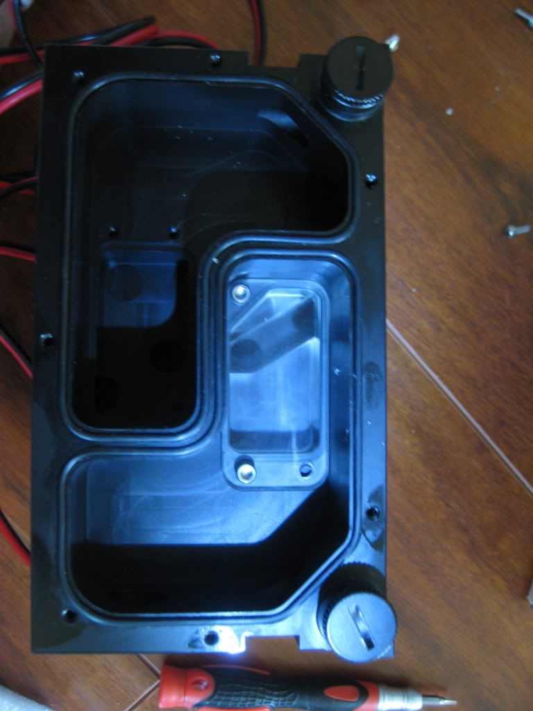

Im gonna borrow this guys picture:
http://w7sp5a.blu.livefilestore.com/...814.JPG?psid=1
So the P1 IN = bottom left hole... water goes inside that...
Then it hits a wall with slash which forces bubbles to go escape...
The inlet for the pump is the hole on top.
This will pull water that hole... which is the inlet on the pump, then out P1 OUT.
Then you have a koolance serial bridge, which forces water to goto the TOP right hole.
If you put the serial plate on that hole, it will force the water directly into the Pump's 2 inlet. The hole where the guy put the 90 is the inlet on P2.
Which then the pump pushes out the Rear P2 OUT.
This way, you completely BYPASS the right side.
The right side becomes extra volumn, when you tie the two res's together by removing that separator plug.
The Right side is the problem side.... so just bypass the right side, and use the left side for the bleeding.
If the two res's are tied together, then well, both sides will become = due to gravity.

Martin also mentioned smoother bleeding with the acrylic bypass in the upper reservoir instead of the lower one. We didn't design it that way because there are scenarios where bleeding was worse while doing that. In normal upright orientation, if it works best for an individual customer to place their connecting pipe on the upper rear ports and the acrylic bypass in the upper tank, I say go for it! :)
Tim
Yeah, I'm pretty well convinced there are multiple ways of doing it. To bleed any loop you just need a place where water is calm enough to allow bubbles to rise to a surface...doesn't really matter where that is in a loop. It could be before or after either of the pumps, but it might help a bit to make it first to catch the larger pockets of air before they get diced in the pump. Having the main reservoir first also helps with priming/filling, but even that can be done with some variation. In my test I probably should have moved the connector pipe to the top as Naekuh shows since I used the acrylic insert in the right/upper.
I am with Naekuh on the connector/acylic insert. I liked using the insert in the top/right reservoir so I could utilize the lower ports in the left/lower reservoir. It's not really meant for that, but I thought it was a bit easier than using the original baffles so less air gets trapped in the right/upper reservoir.
You could omit the acrylic insert all together, but then you'll have to either top off the right all the time or push the air back into the loop. With the insert in the right/uppper, you'll still have to bleed off the air there, but there is less of it than with the baffle.
The connector pipe is also optional...you could easily place a block in between the two pumps and just use the loop to connect the pumps in series. I even had one user say he thought doing that was better for noise? Haven't tested or noticed that myself, but who knows.
The only thing I'm really sure about is that I made it work a few different ways, and there are likely a dozen other methods that will also work..:D
well that serial acrylic insert basically asks you this question.
Do you want your inlet in the center of the res? or do you want it in the lower portion of the res?
Because the serial insert has a oring, im fairly sure it will seal that compartment.
This is why i said, you need to open the separator plug, so you can use the right side as extra storage.
Then the bubble isnt trapping on the left side.
