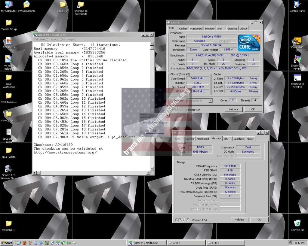

hey radaja or anyone else in the thread.. I had some fun last night with the i5 660 on the maximus III formula. hwbot seems to be down at the moment so I'll try to send some screens instead and you can validate later. is there a way I can log into cpuz canard and log into my account and see my submissions or does it not keep track by username and email? I really need to get the valid id off a particular G6950 bench. I think I had something good and I never saved a screenshot but I did submit to the database online and got a url but I have no idea what it was!
i dont know on that.there should be a way to recover old url's.i know ive lost a lot of them and cant remember what happened to them.
EDIT- i just logged into this url and it brought up all my submissions
CPU-Z Validator 3.00
sweet! hang on! here are the i5 660 results from last night. I ran out of ln2 a bit early. I was being such a puss with the vcore. I shoulda just cranked it from the getgo. oh well at least the cpu still works. I gotta say this maximus 3 Extreme has been to hell and back and it always works. I mustve done a really good job when I sprayed it down with conformal coating. I was just getting started :(
http://i239.photobucket.com/albums/f...%20660/152.jpg
http://i239.photobucket.com/albums/f...x26qpi1790.jpg

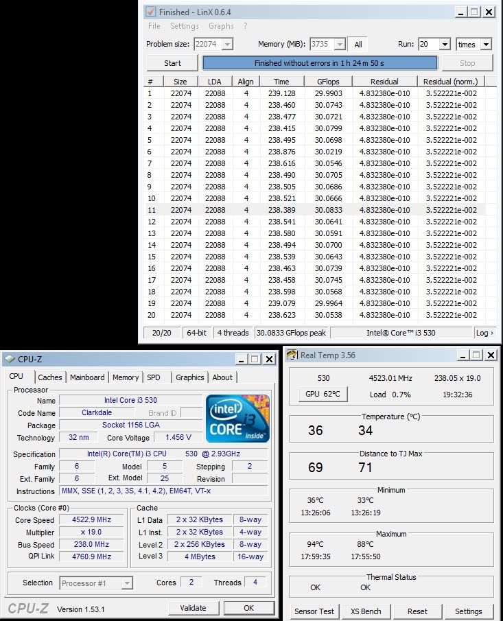

This cpu is the hottest thing this side of the sun. My zalman 9300 just cannot cope with it. Load temps are ridiculous. 4.52 HT on @ 1.32v gives load temps of 97c in linx. Hoping to get water fitted this weekend, may be held up if the res doesnt show in time. Likes the 19x multi, getting 60mhz more cpu same volts compared to any other multi. Limited by bclk now, cant figure out whats stopping me. Could just be P55 limitation, not seen any other P55 rigs running 235+ 24/7 stable.
Will upload 20 run linx later today.

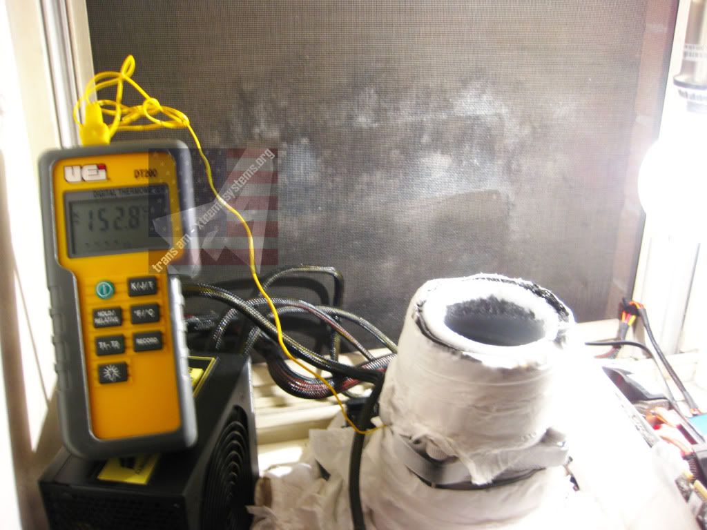

did the cold boot mod and im ripping in at -150c!
i have the i5 660 strapped so expect some good stuff!
