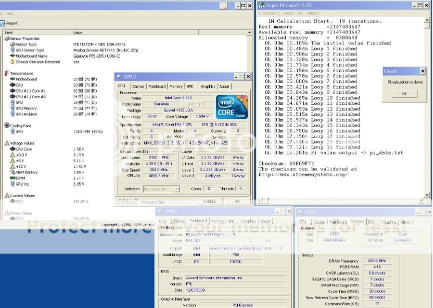

Did a PI run with high QPI & it obviously ran faster
http://i967.photobucket.com/albums/a...5/2aeb14bb.jpg
