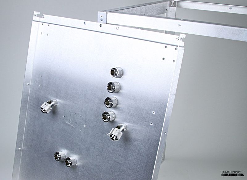

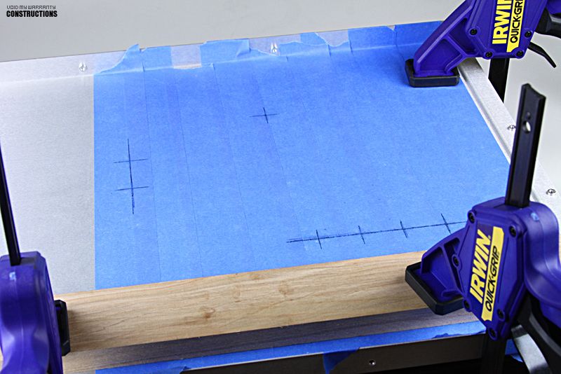

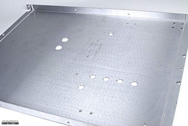

Here is the bottom panel of the hull which is also the top panel of the pedestal.
Prepped, masked, clamped, marked and ready for surgery:
http://lh5.ggpht.com/_QLiEm5wyerY/Su...0/IMG_3588.jpg

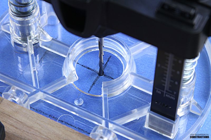

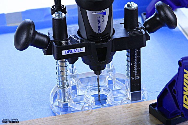

Busted out the dremel to carefully mark the starter holes.
http://lh6.ggpht.com/_QLiEm5wyerY/Su...0/IMG_3586.jpg
http://lh5.ggpht.com/_QLiEm5wyerY/Su...0/IMG_3590.jpg

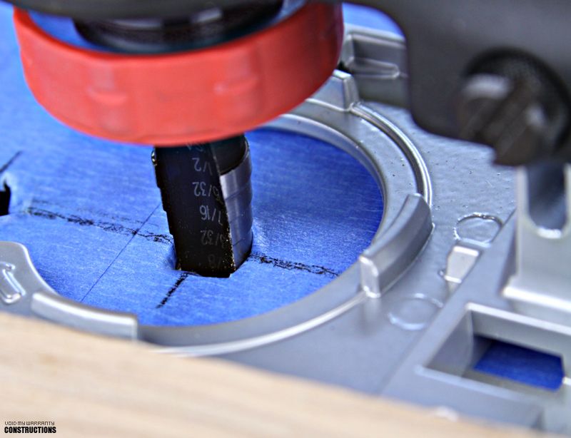

Unfortunately, I was unable to find a large enough collet for the Rotozip to fit Chuck the unibit. Hey. That rhymed! (Yes. I'm easily amused).
So I took a smaller unibit (Chuckie), drilled just one step short of 9/16th (Chuckie is shorter than his dad).
Then I took Chuck and did the last step to 9/16" freehand.
It's a pretty unorthodox way of lining up holes, but for somebody who doesn't trust his own freehand drilling abilities, it worked out better than I thought.
The less this kid drills freehand, the margin of error decreases exponentially.
http://lh5.ggpht.com/_QLiEm5wyerY/Su...0/IMG_3596.jpg
The clamped wooden guide performing its duties well:
http://lh6.ggpht.com/_QLiEm5wyerY/Su...0/IMG_3592.jpg
After the procedure and the bandages removed, I was pleased with the results:
http://lh5.ggpht.com/_QLiEm5wyerY/Su...0/IMG_3598.jpg
http://lh5.ggpht.com/_QLiEm5wyerY/Su...0/IMG_3601.jpg

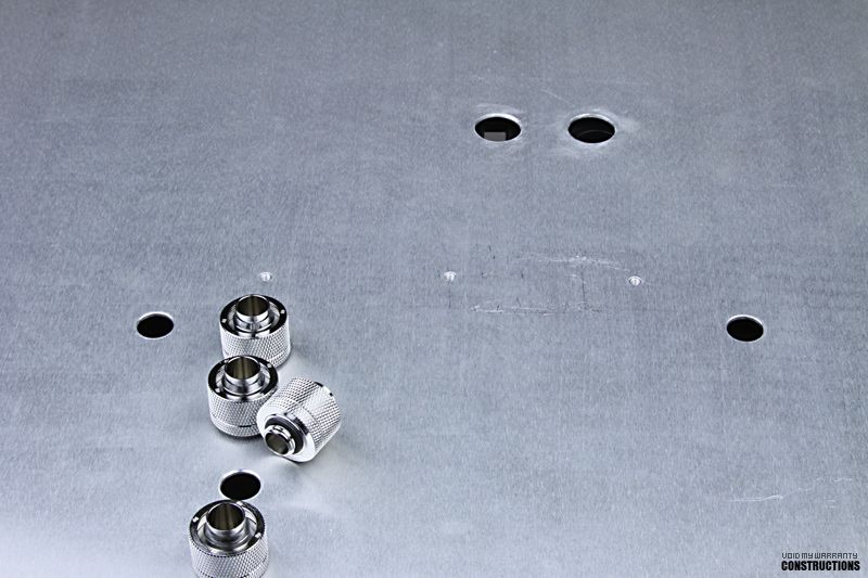

I placed the end of a straight edge T against the lip of the bottom panel to see if the fittings lined up.
They lined up perfectly!
Sweet.
http://lh4.ggpht.com/_QLiEm5wyerY/Su.../IMG_3603a.jpg

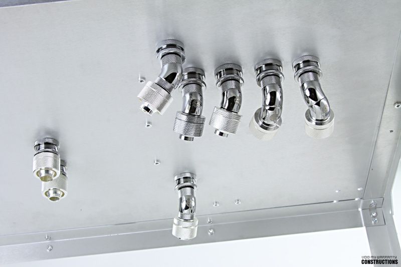

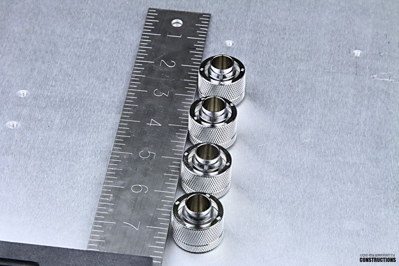

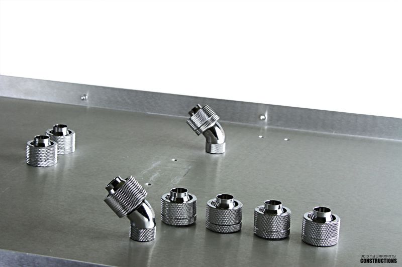

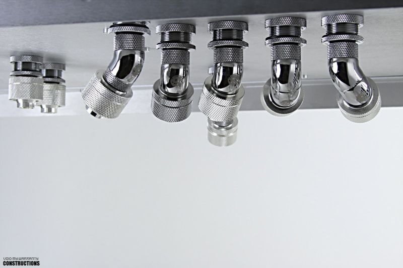

Here's the top panel showing the compression fittings and a couple of 45 rotaries connected to pass-through fittings:
http://lh4.ggpht.com/_QLiEm5wyerY/Su...0/IMG_3605.jpg
http://lh6.ggpht.com/_QLiEm5wyerY/Su...0/IMG_3617.jpg
Deployed the fittings to check for clearance.
Verified that there's ample room to break dance upside down on the crowded dance floor:
http://lh4.ggpht.com/_QLiEm5wyerY/Su...0/IMG_3615.jpg
Ant's Eye View:
http://lh4.ggpht.com/_QLiEm5wyerY/Su...0/IMG_3611.jpg

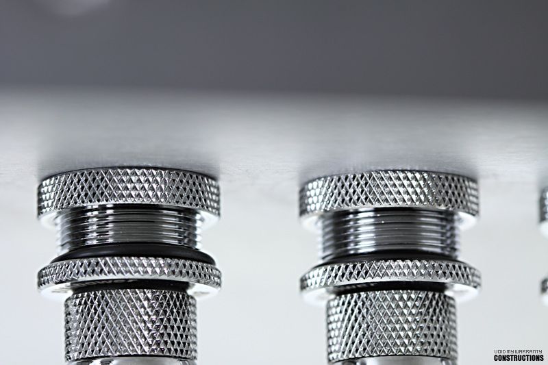

The O-ring will be placed on the chassis side after powedercoating. I just didin't want to place unnecessary wear on them.
I'm sharing this with you in case you didn't know.
Friends don't let friends use worn out O-rings:
http://lh6.ggpht.com/_QLiEm5wyerY/Su...0/IMG_3618.jpg

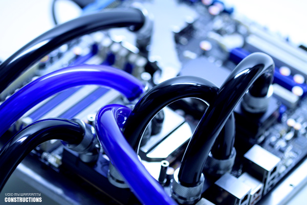

I managed to do a little fiddling with some tubing on the mobo. Looks decent enough for a shot, but still in the process of redoing:
http://lh4.ggpht.com/_QLiEm5wyerY/Su...0/IMG_3640.jpg
