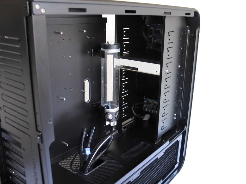

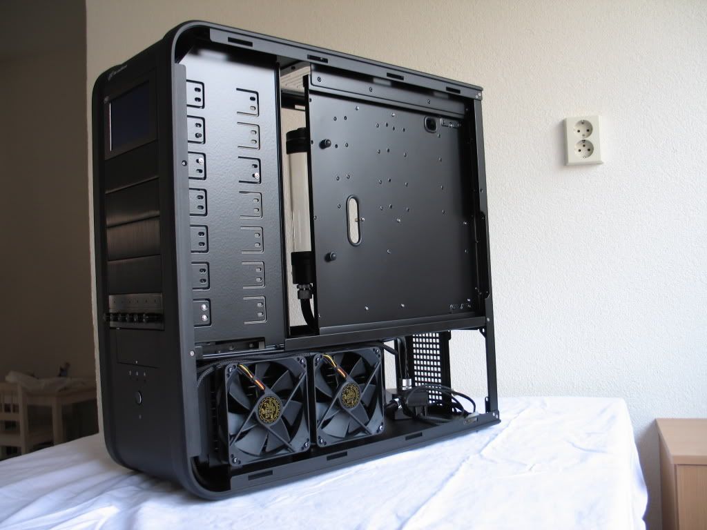

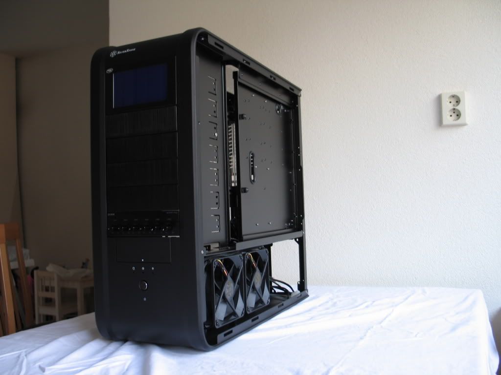

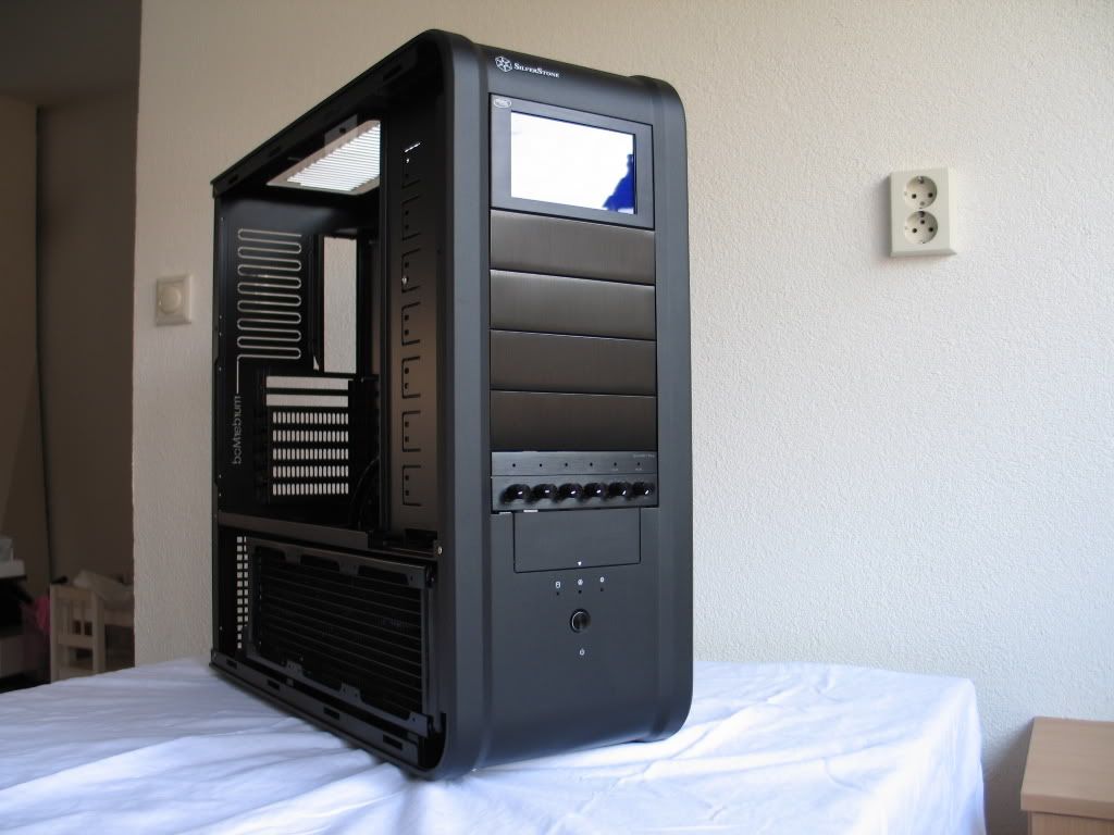

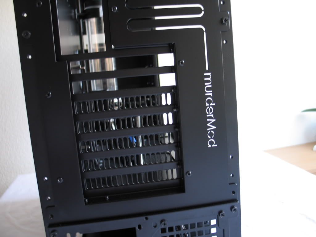

Impatience got the better of me so i decided to put parts together, just to see how it looks. :cool:
Haven't got any reply to my email about the PSU :mad:, i will put things together now and hope i can put the PSU in later without having to take it all apart again. (yeah right! :D)
I'm sure i'll end up taking it apart again but we'll see. :)
Here goes:
http://img.photobucket.com/albums/v6...d/IMG_5695.jpg
http://img.photobucket.com/albums/v6...d/IMG_5692.jpg
http://img.photobucket.com/albums/v6...d/IMG_5689.jpg

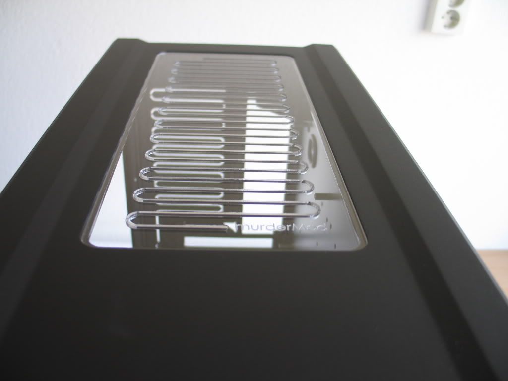

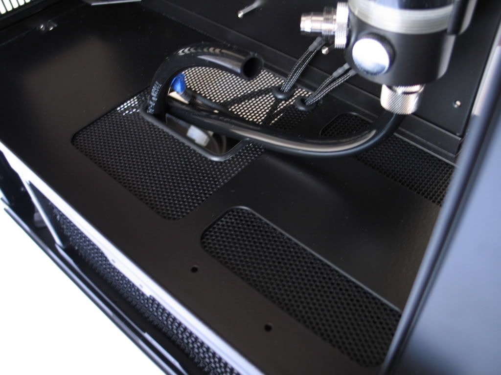

Revealing the idea of the hacked up topgrill:
http://img.photobucket.com/albums/v6...d/IMG_5678.jpg
http://img.photobucket.com/albums/v6...d/IMG_5673.jpg
http://img.photobucket.com/albums/v6...d/IMG_5685.jpg
It's a little messy now but it will all be worked out in the end.

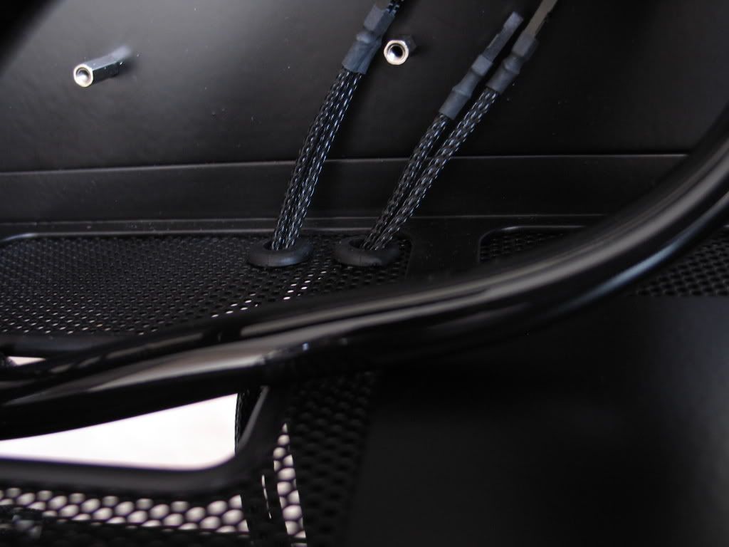

http://img.photobucket.com/albums/v6...d/IMG_5667.jpg
Attention to detail
http://img.photobucket.com/albums/v6...d/IMG_5665.jpg
http://img.photobucket.com/albums/v6...d/IMG_5666.jpg

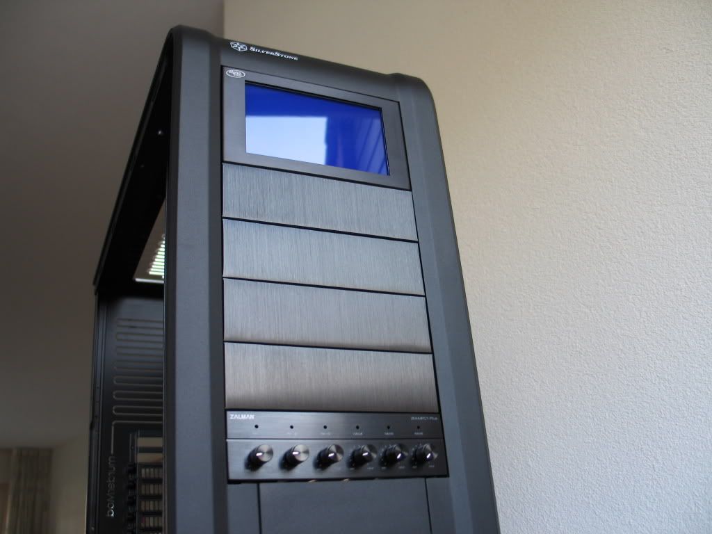

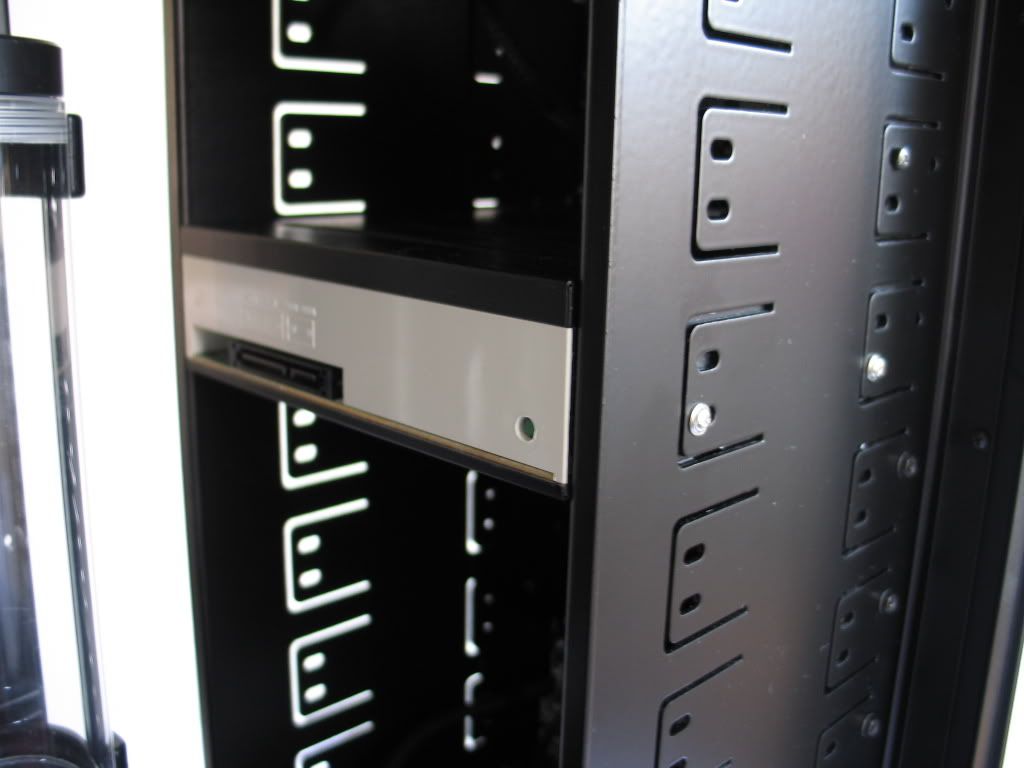

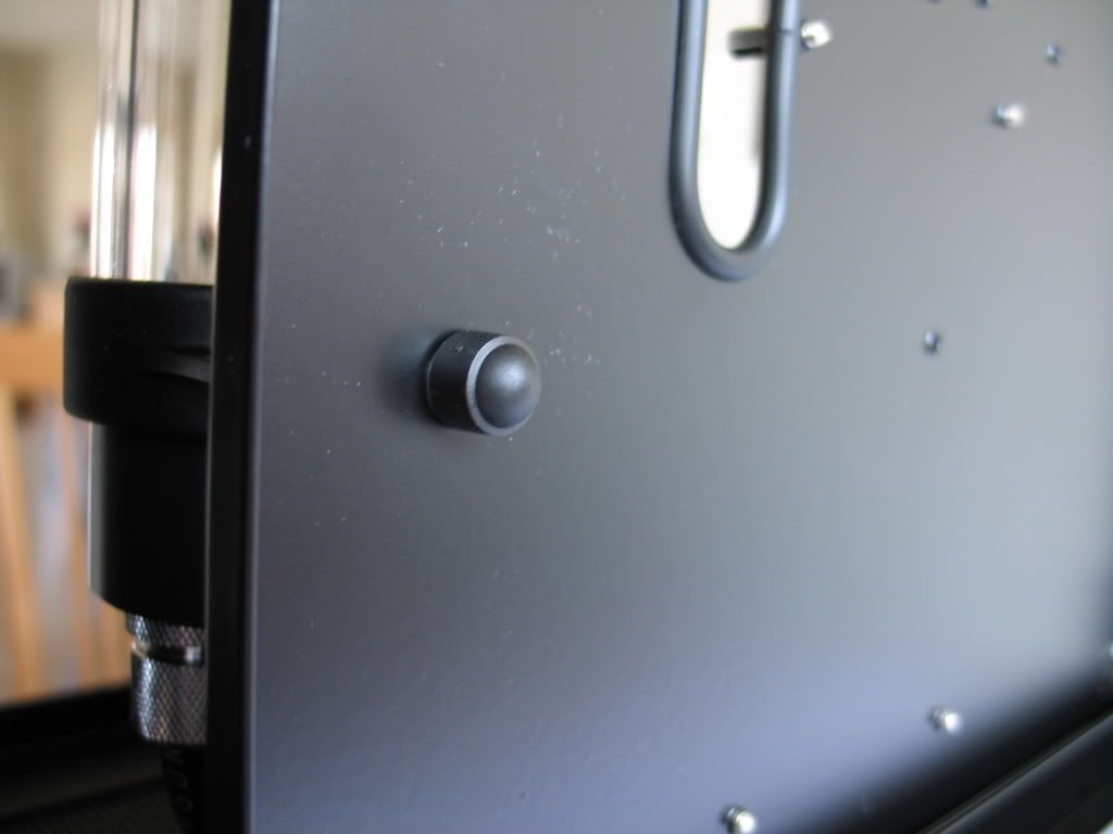

I had a fight with the optical drive but i managed to get it worked out, stealthed!
http://img.photobucket.com/albums/v6...d/IMG_5702.jpg
I mounted a small button in the backside for opening up, just in case. :D
http://img.photobucket.com/albums/v6...d/IMG_5677.jpg
Hope you all like it, the screws will off course be replaced with black ones.

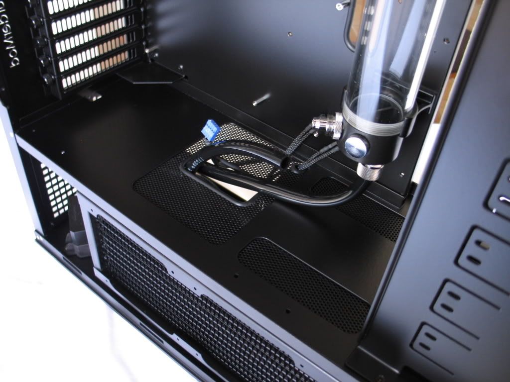

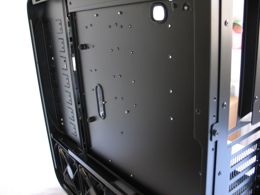

Could you do me a favor and take a picture of the underside of the mid-plate to see how you fastened the mesh to the plate. I really like the meshed look there. Double-sided tape?
Also, it looks like you abandoned the idea of using the Lian Li optical drive cover. How did you stealth it? Double-sided tape to front of tray?

I was afraid of this question coming. :)
Actually i didn't take pics from the underside as it doesn't look that great. I've thought about using double sided tape but sticking that to mesh would attrack way too much dust so i opted for hot glue.
Here you can see a little of it:
http://img.photobucket.com/albums/v6...d/IMG_5693.jpg
The dvd drive is quite a story in itself.
Basically, i removed the original front, sanded down the part that's on the drawer (don't know if that's the right word?). Then i took a black plastick bezel of an old pc, cut off the sides, drilled 2 holes in it (countersunk) and then drilled 2 holes in the "drawer" .
I screwed the plastic bezel onto the front of the drawer with 2 hammond box screws, took a bezel of the TJ-07, cut off the sides with the dremel and placed it over the plastic bezel.
Tight fit so no need for glue or double sided tape.
I hope you understand, i didn't take any pics during the process, i should have. :p:

The mesh was an idea i came up with when i mounted the midplate, i didn't like the look of the 3 large holes actually.
The topgrill is just big enough to cover up the holes when hacked into 2 pieces, really only just, one slip of the dremel should have screwed it up, fortunately i managed.

Actually, I think that is a very neat job you did with the hot glue and mesh.
Also, it sounded like quite the process for the optical drive cover. Nothing is easy with that. I wish they would make a bay cover like Lian Li.

No pro. ;) Actually i wanted to mod one of those Lian Li drive covers but it seemed way to complicated, that's why i went with just a plain stealth look.
The front cover was a bit of a hassle as it protruded a little so i kept sanding it down till it fitted. That took the most time actually.

You know you were worried bout the hot glue, couldn't you just paint over it ? then it wouldn't be as noticable.
Just a thought.
Ninja
Yeah i could have done that but i'm not sure it that would have made it any better to be honest. It's pretty much out of sight so it does not bother me that much.

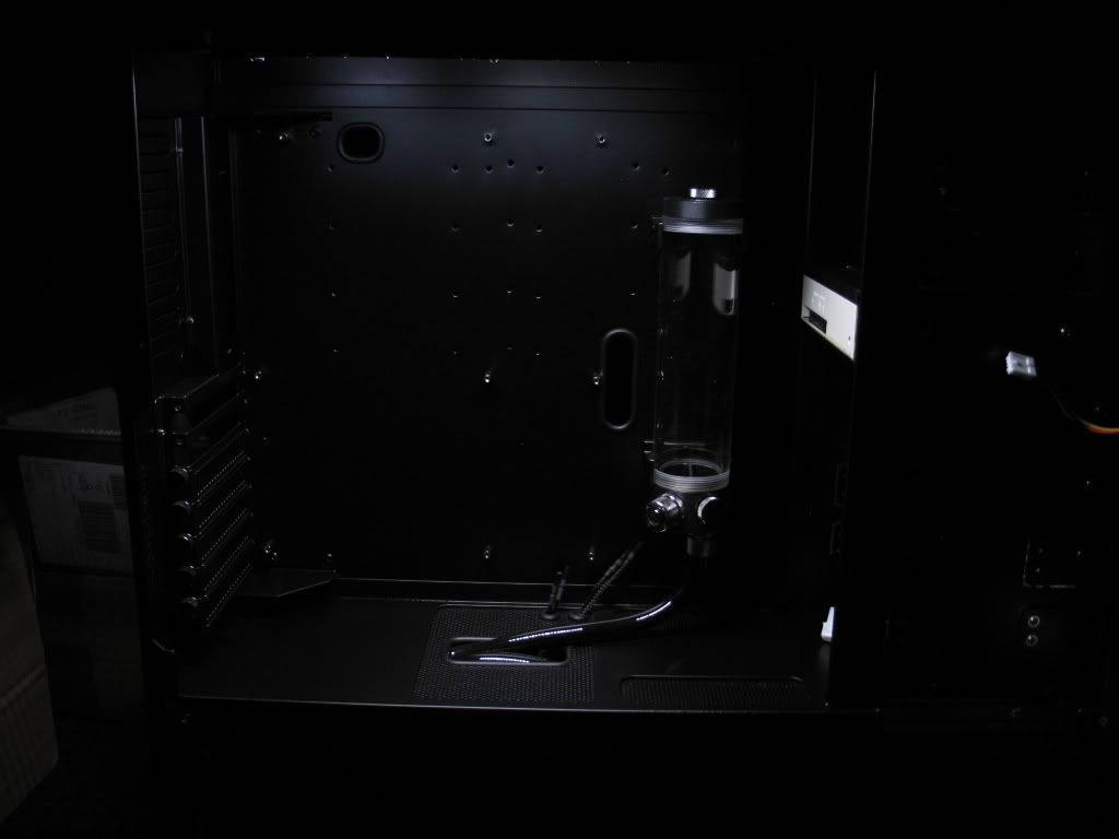

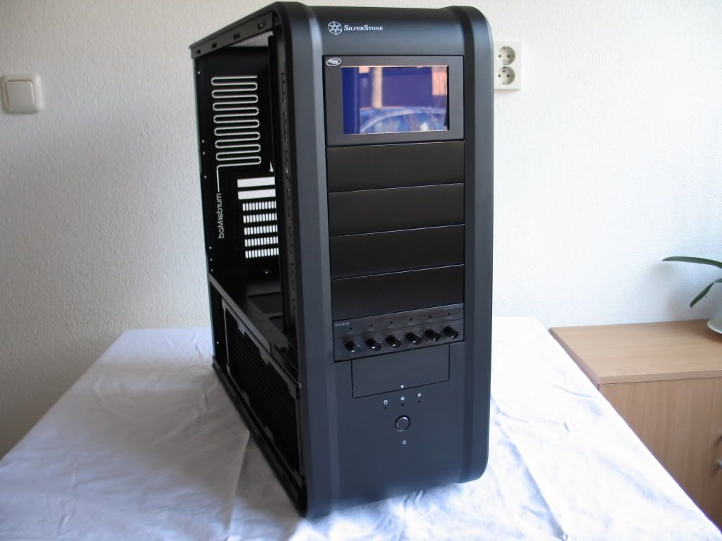

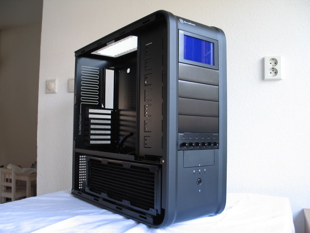

Today i've been busy building in some lights, i wanted the case to be lighted even and i did not want the light to stand out too much, i think i succeeded pretty well if i may so myself.
http://img.photobucket.com/albums/v6...d/IMG_5732.jpg
It a strip of white leds mounted in the top on a Zeus special assembly. :rofl:

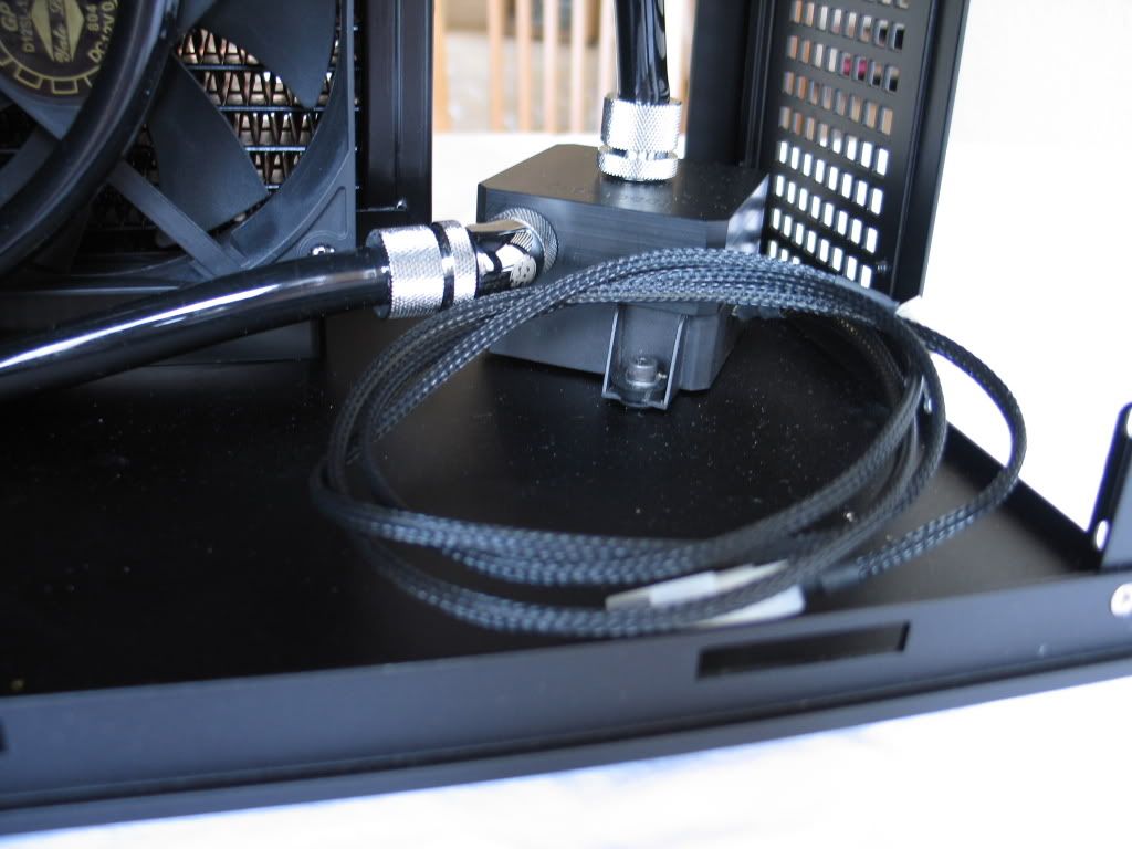

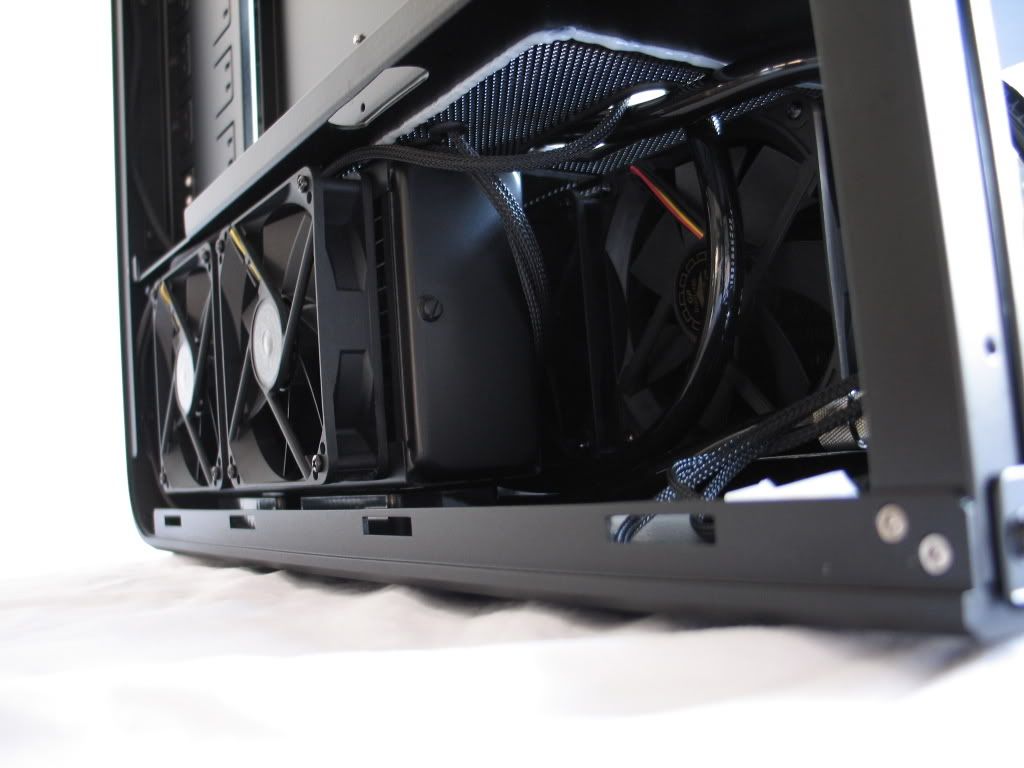

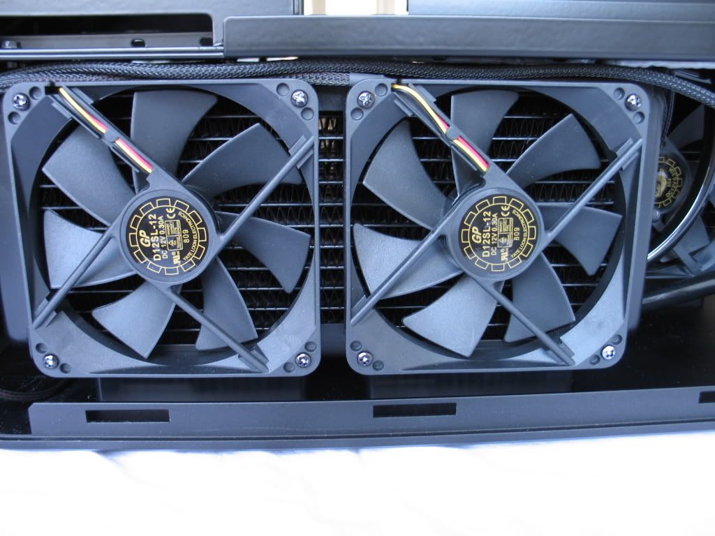

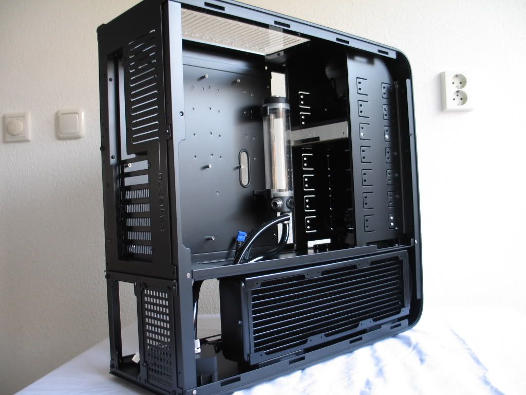

Just wondering how are the rads attached to the hammond boxes ? Have you used double sided tape ?
Yes double sided tape.
I don't understand why a lot of people ruin the paintjob with tape when there are holes in the side of the rad. I mount my rad in those holes with a couple of m3 screws and it works like a charm. Wont ruin the paintjob either.
I've thought about that too but the hammond boxes i used aren't wide enough to take up the screws.
I'm not too worried about the paintjob, if i'll ever use the rads in another setup i'll repaint them if needed. ;)
wow man that is one beautiful looking case.
You got a better view of your special LED placement ?
Ninja

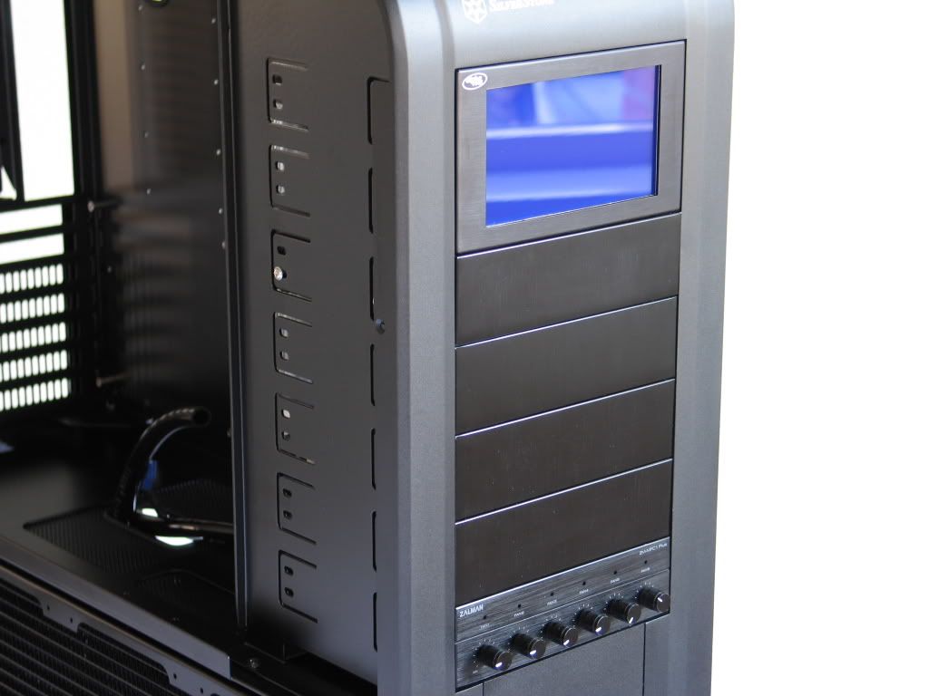

this build is looking very nice indeed, i just gotta ask, what is that big LCD screen you got on the front of your case?
