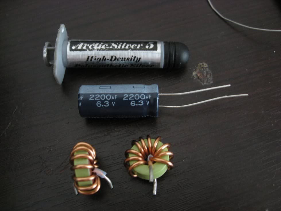

Ohhhh.......C'mon you guys.......!...... :D .....Who's gonna solder extra coils in parallel with the existing ones so to avoid the BIG Vdroop of it and then test it in real?.....
ONLY thing you need, is to unsolder some coils from an old motherboard and then solder them onto the VGA with a lot of heatage on the soldering iron..... ;)
hipro5 The purchase of the coil also I shall try to make this mod.
Get some .68uH at 25A+ each (at 25*C)..... This you can be put?
hipro, i'll give it a go.
Can i use the caps and R47 coils from a P5B Deluxe?

For anyone interested in performing hipro's vGPU smoothing mods, here's a confirmed correct diagram of how to achieve it
http://img.photobucket.com/albums/v3...scan-front.jpg
The caps need to be electrolytic 1500, 2200 or 3300 uF with the '-' terminal on the ground side of the SMD cap, and the '+' terminal on the vGPU side.
The coils should be from an old mobo and just soldered across the existing ones.

Tried the caps couple weeks ago, not of great use, no better overclock or higher benchable voltage. It's the coil that needs a mod. 'Any coil' will not help, you need right value's.
Darn, and i was about to do the mods with 'any values'.
So, what do i need?
Hmmm, i went to an electronics shop and they had a box full of unlabelled ones.
So i just grabbed a handful of them and a handful of 2200uF 6.3V electrolytics.
Is it the size that determines the value? If so from a photo could you say if OK or not?
http://img.photobucket.com/albums/v3...icture0011.jpg
http://img.photobucket.com/albums/v3...icture0021.jpg
going to do this now that there is a picture!!!
