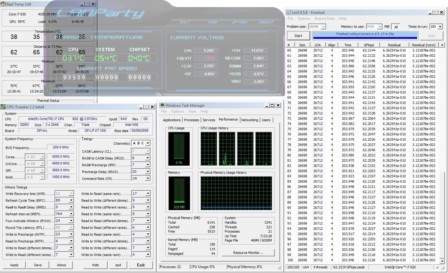

I run a E8400@4Ghz and i get very different values between runs:
When it works like it should I get around 28.5gflops and high temps on my cores but sometimes the test runs at half speed and it does only around 15gflops and temps are 10 degrees lower.
I have decent temps so it's not thermal throttling and linpack uses 100% cpu load...
could be hitting page file thats why i select max memory and then back off by 50mb and then let it carry on testing.

I found a strange issue with last LinX.
Using Win7 x64 7100 official.
Processor i7 975 8 virtual cores, 6 Gb RAM.
Set 4 cores used in LinX and 5300 Mb of RAM.
It starts correctly, I see with task manager that occupies correctly all the memory and that the average load of the 8 cpu is 50%.
After some minutes I see that every cpu go near 0% load and I expect to have the first result on LinX.
No way, the cpu remain near 0% of load, the memory taken by LinX stays at 5300 MB and nothing happens. I waited for 10 minutes and after I shut down the program that is not blocked as it accept every command.
I tested same setup with last IBT and it worked as expected.
