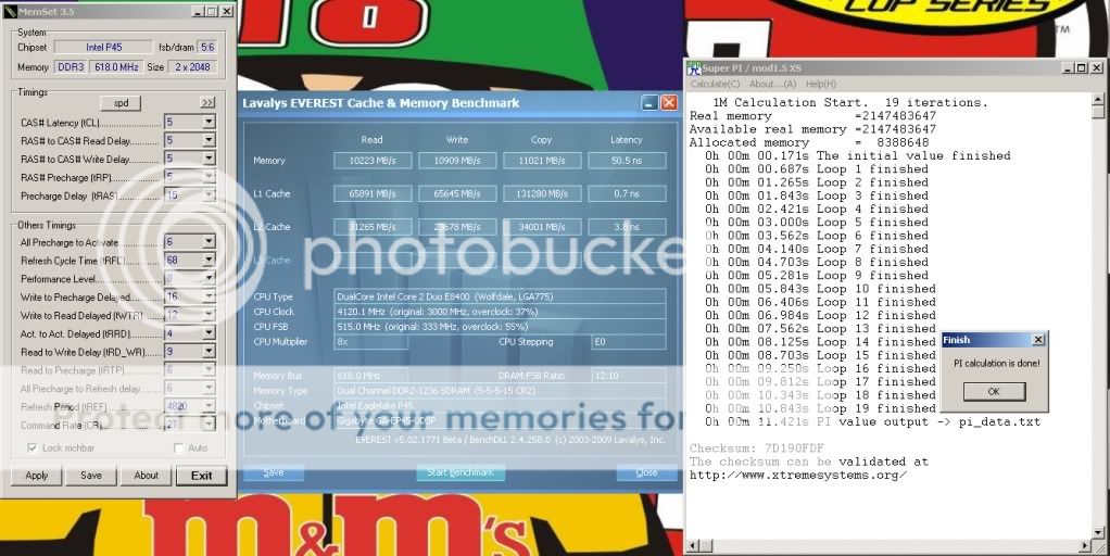

Well got some Pi 9600s and started to play. Since I'm still fairly new to my mobo, it's not easy. Memtested fine at stock but had trouble going over 1200. Decided to see what they do with tight timings:
http://i383.photobucket.com/albums/o...i10004-4-4.jpg
not bad for a 2x2GB kit.

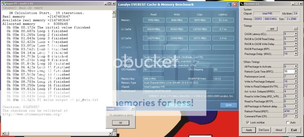

Just to compare bandwidth, I took the same 417 FSB and raised the timings and speed:
http://i383.photobucket.com/albums/o...004-4-4555.jpg
