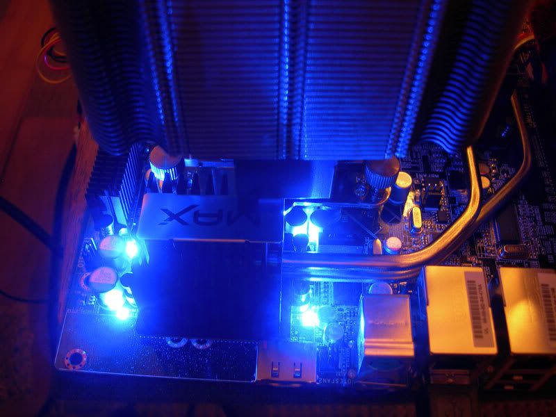

I need sunglasses working with this setup.
http://img.photobucket.com/albums/v31/canny/blight.jpg
heh,almost like Las Vegas skyline;)

If you can fit it in your case it may solve all of our problems! :)
It's listed as a "SLI bridge" on abit's parts store :stick:Quote:
Originally Posted by G H Z
http://www.abit-usa.com/abitparts/miscellaneous.php
GHZ.... yeah .... it is the SLI bridge... :DQuote:
Originally Posted by Heidfirst
The Nemesis... yeah it need thermal paste replacement... AS5 would be nice
