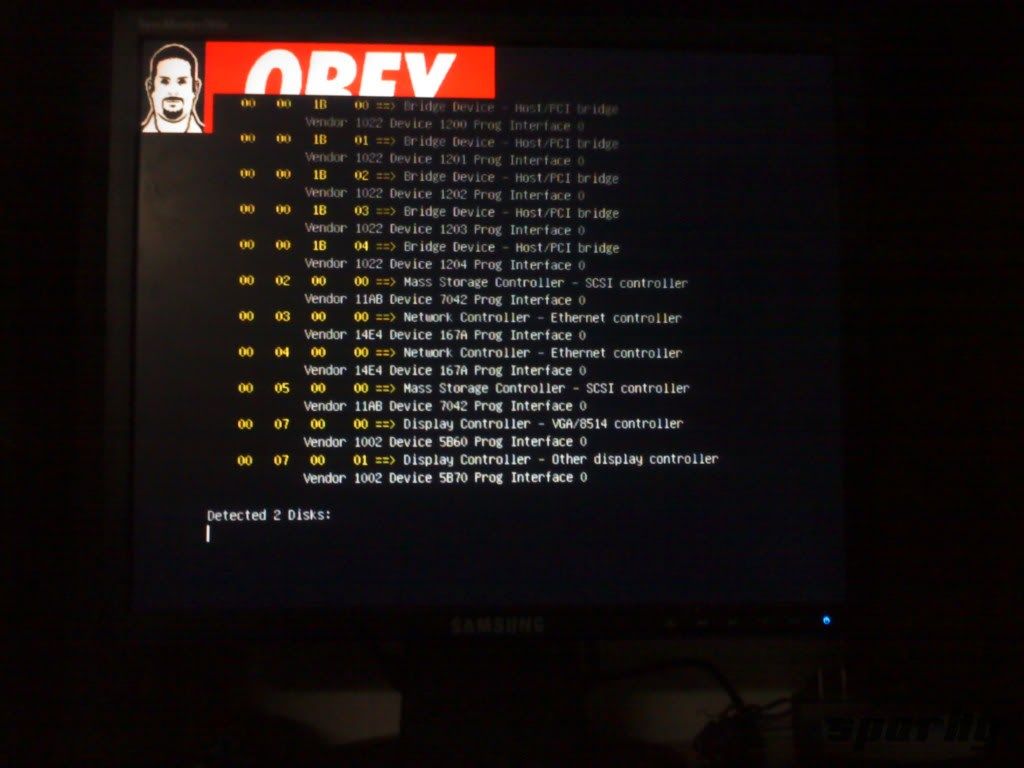

Anyone know how this EFI shell is supposed to work? It starts to this point then just seems to freeze at "detected 2 disks"
http://i58.photobucket.com/albums/g2...061024x768.jpg
*edit* interesting, it only hangs there when I have the SATA DVD ROM plugged in to sata20. More experimenting to be done... I see that in the IDE config in the BIOS is shows parallel ATA - but I see no PATA ports on this board!
*edit2* The EFI shell hates the SATA DVD ROM drive. If I swap the ports, then right before it hangs under the detected 2 disks it will show the hard drive, then hang. Hm. This is getting a little frustrating.

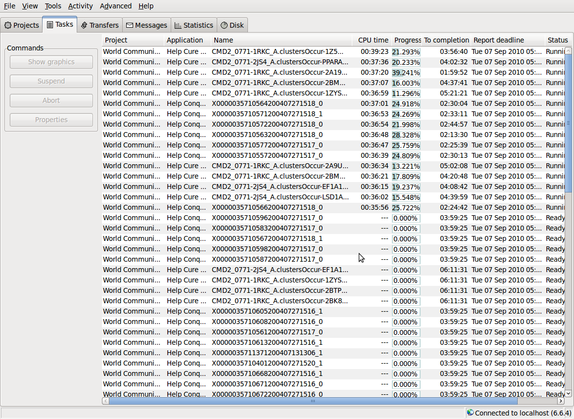

Well it is installed, I used a guide I found here for the BOINC install. It's an old "pre-release" version though so maybe I need to update it :shrug:
And... I think I have enough cooling. Temps are upper 30's, not even hitting 40C :rofl:
This is just epic, though... :slobber:
http://i58.photobucket.com/albums/g2...regoodness.png
let me ask you something. when you're viewing that page does it refresh itself or do you have to move the mouse within the window to "update" it?
I have to move around in it for it to update. I thought it was frozen at first. Guess it has something to do with a linux thing because I noticed that when my mouse was outside of the console window I couldn't type in it.
yeah mine does that too. it looks frozen but it's not. pull up system monitor and look at the beautiful graph of sixteen cores working at the same time :)
