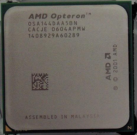

CACJE 0603FPMW :cool:

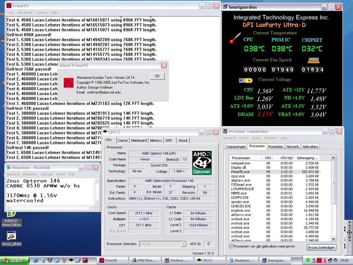

Opteron 146 at 3100mhz (310x10) @ 1.55v with 166mhz memory divider and 2x1GB Gskill ZX (3-3-2-6). CABZE 0604EPAW. Still working on it.
http://home.comcast.net/~jhatfie/opteron146_3100.jpg
