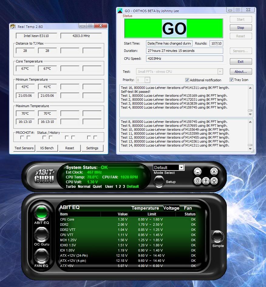

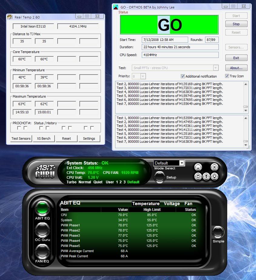

Old thread, but figured I'd add my current results with a 45nm chip in case anyone is interested ;)

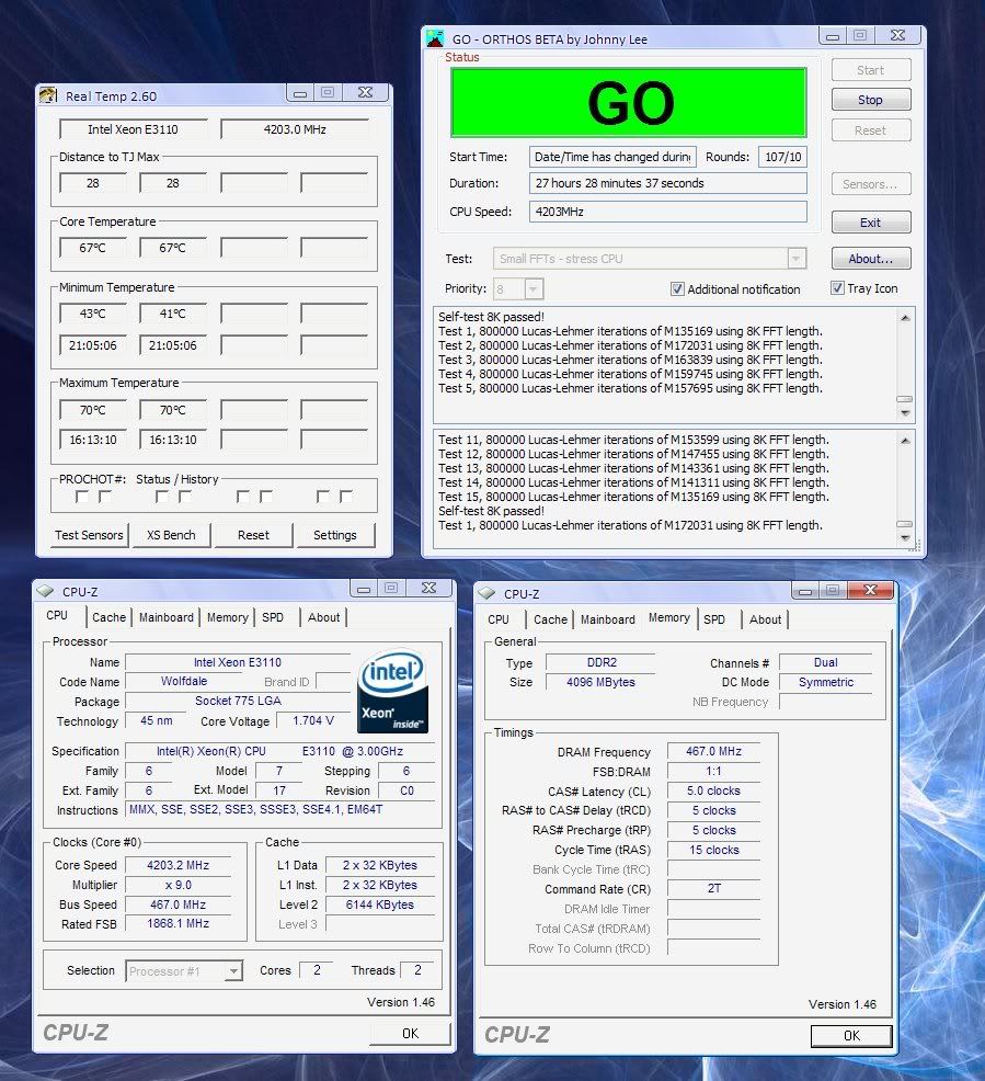

I flashed to the newest beta bios and installed an e3110 last week. I'm still testing, but so far I've gotten it up to 4.1ghz (9x455.) I'm currently testing to see if the board will do 467fsb (6x467,) and if I can get that stable I will shoot for 9x467.
As of this morning, 467fsb was 12 hours Orthos blend stable with 1.55v MCH and 1.2v ICH. 455fsb was stable with only 1.4v MCH, so I have a feeling that my board is running out of steam when it comes to fsb.
I'll post up screenshots once I finalize my 24/7 overclock :up:
Looking good. I am going to add one of these bad boys to my rig in about 3-4 weeks along with a 4870x2 vid card a few weeks after that. That will keep this system humming along nicely for some time to come. :)
Results:
http://i41.photobucket.com/albums/e2...g/41ghztwo.jpg
http://i41.photobucket.com/albums/e2...g/41ghzone.jpg
4.1ghz is Orthos small ftt stable so far with 1.325 vcore set in the bios, along with 1.4v cpu VTT, 1.45v MCH, and 1.15v ICH. I can get it to be ~4hr Orthos blend stable at 4.2ghz with 1.345 vcore and 1.55v MCH, however the temps on my PWM's climb into the mid-80's. I did not bother pushing voltages further to get 4.2ghz stable because of this heat...I have two 60mm Vantec Stealth fans on the way (one will go on the NB heatsink, the other on the PWM heatsink) to try to lower these temps. Then I will see if I can get 4.2ghz 24 hours stable.

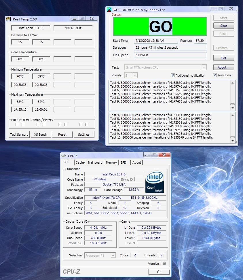

4.2 GHZ:
http://i41.photobucket.com/albums/e2...g/42ghztwo.jpg
http://i41.photobucket.com/albums/e2...42ghzthree.jpg
http://i41.photobucket.com/albums/e2...2ghz3dmark.jpg

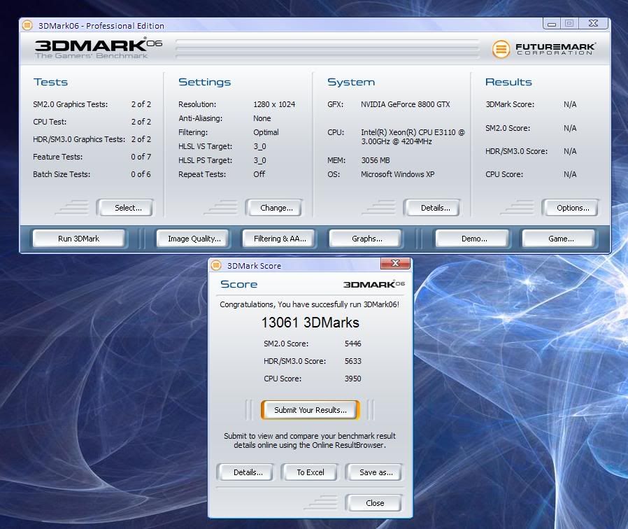

I'm not 100% sure if I will stay here or back down to 4.1ghz for 24/7 usage though. 4.1ghz is stable with 1.325v (bios) and 1.45v MCH. 4.2ghz requires 1.355v (bios), and 1.55v MCH. The idle volts for 4.2ghz fluctuate around 1.32-1.34v, with the occasional spike up to 1.36v according to uGuru, load is right around 1.3-1.32v. So technically, the voltage should be ok. My VID is pretty high, so I'm only at a 15% increase in voltage over stock, which isn't bad. The max core temp of 70c in one of my screenshots looks a little too high, but that was in the middle of the day when my 2nd floor was probably around 95F (the central air doesn't reach up to the 2nd floor too well, but I have a secondary air conditioner that I run at all times when I'm actually up there. I usually keep it in the mid-high 70's.) It isn't that bad if you take that into consideration...
Honestly the 1.55v MCH is a little more concerning than the vcore, but considering that I've seen a lot of people run this board up over 1.6v, then perhaps I shouldn't be too concerned.
Enough of the worrytalk though, I got almost 1000 additional 3dmarks over my old 3.3ghz e6600 overclock, and all of my Sandra scores skyrocketed :clap: So all in all, I'm a happy camper!

:eek: 1.7v on a 45nm chip :eek::eek:
Just ignore the cpu-z shot, it has never shown correct voltage on this board. The real setting is 1.355v in the bios, ~1.34v real idle, ~1.31 real load.
